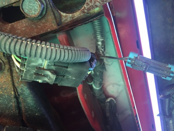

    I picked up a 2000 GMC K2500 last week and need to install a hitch.
    I was going to order the hitch and wiring online and do the job myself. E-trailer has some good vids on wiring however when I looked under my bed I noticed that the existing wiring is connected by a 4 way flat and it runs from the driver's side then across the bumper and up into the bed wall on the passenger side. I have no idea what it controls. There isn't an existing trailer plug on the vehicle. It has a step bumper with a bumper ball but no place to plug trailer lights into it. I plan on adding a hitch with a trailer brake controller.
    I've attached a pic of the 2 4-way flat connection.
    Any ideas? I've watched several vids on e-trailer's website and haven't seen anything like this.

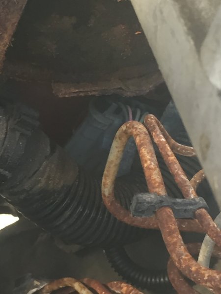

    Engine compartment
    Under tailgate. The small plugs are for the license plate lights.

    Looks like I need a T connector instead of the connector I was originally looking out.

    Ordered a class 4 hitch and the T connection. Skipping the brake controller for now since none of my existing trailers are equipped w brakes.
    The wiring going across the rear is for the taillights. Derp! Lol

    Lol I wasn’t fast enough to tell you, went through that same exercise on my 97 1500 Silverado trying to figure out how to wire it . T connection and good to go like you just figured out.

    pull back your front drivers side floor mat the trailer brake wires might be there already, just have to find them the other end. Also if you add brakes you will need a 7 pin connector

    Do a search on etrailer they say all the wiring is already there in the truck just needs connected. wires thru firewall and the rest are tucked up above the spare.

    Sometimes the 12v charge wire (orange) and trailer brake wire (blue) are already at the back taped back into the harness, might have to pull some tape off to find them, under the hood charge wire should be near fuse box with an eyelet that can be put on one if the two studs on the fuse box
    Under the dash, can't seem to remember where the brake wire is
