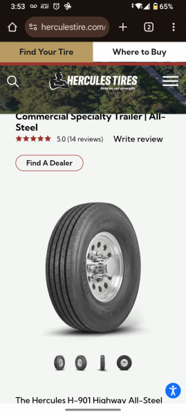

    These if they come in the size you need
    We run them on about 8 trailers at work.
    Wear like iron
    14ply carcases
    Hercules H 901
