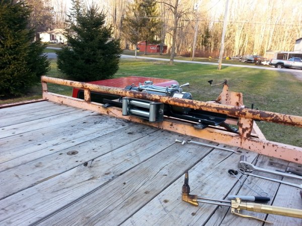

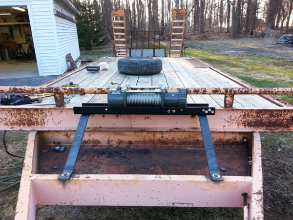

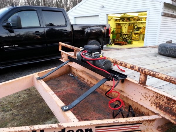

    Keep your eyes on craigslist. I found my deckover for $2k and added a 12ooolb winch for $299 from Harbor Freight. I looked for months before this deal came up and jumped on it right away. Still need to turn the ramps into gates with expanded metal for the stuff with 3 wheels or offset fronts and rears.
