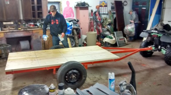

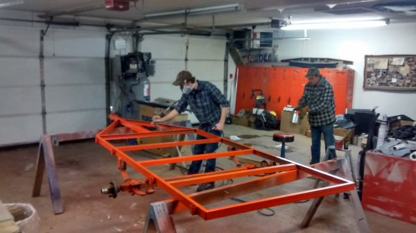

    Can't tell you how it will hold up as my son and I just built it. We used the rustoleum brown primer and covered that with GTO Judge orange the neighbor had left over. Looks good, at the moment.

    Thank you. Found the axle buried in tall grass when we bought the farmstead. Almost threw it in the scrap trailer but saw it had bearing buddies on it and the hubs turned freely. Since we homeschool and my oldest gets bored with book work, we built the trailer as a shop project. It turned out pretty good and he has a utility trailer of his own now.
