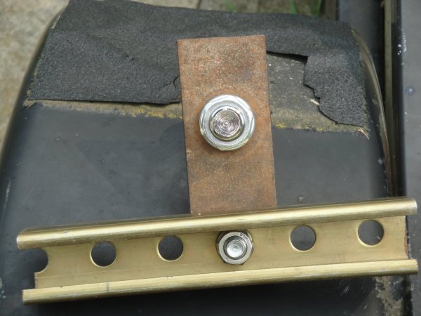

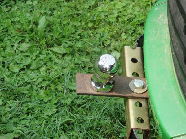

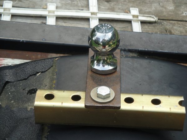

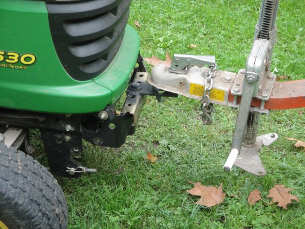

    After a long time thinking of how to put a ball on the front of my garden tractor, considering my lack of knowledge and skill in working with metal, I came up with this rube goldberg thing. It even works. I had an 8 inch piece of uni-strut and a piece of 3/16 steel with holes already drilled. I had to buy a new 1-7/8 inch ball for it all to come together.
    It lifts off very easy.
  2. Eric VW
    24,398
    140,392
    Nice job Erik B :salute:
    Only concern I have is the hitch plate trying to rotate since you don’t have 2 points of attachment at the Unistrut. If you know someone with a welder, have a bead placed under the hitch plate to the Unistrut or at the back edge of the plate to the back face of said strut.
    If ya can’t find anyone who welds, you could drill a hole in the plate just a smidge off the front face of the strut and add a bolt and nut to provide anti rotation of your hitch plate and ball hitch.

    I wrenched on it pretty hard. I am going to use it to park my splitter in my pole barn. It should be easier driving forward than backwards. If I see it do any moving, I will find a way to fix it. Thanks Eric VW for pointing out an area of concern.:handshake:

    ironpony If you look at the first picture, the black bracket on the tractor goes along the front of the uni-strut and it wedges itself between the nut and the front part of the uni-strut. When I put weight on the ball, nothing moves.

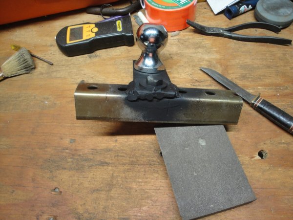

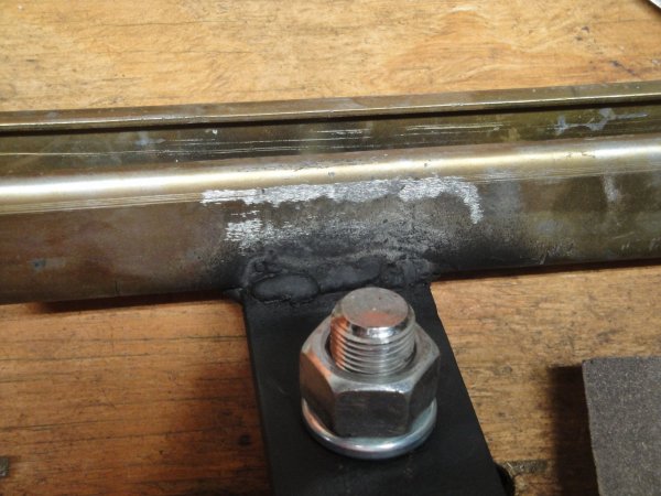

    Asked a friend who is real handy if he had a welder. He did and invited me over this afternoon so he could work on it. He had a Harbor Freight wire feed welder. It only took him a few minutes to do the welding then grind off some of the excess and gave it a quick spray of paint. This should do the trick. Thanks Eric VW for the suggestion.

  13. Eric VW
    24,398
    140,392
    Eggscellent. :D :thumbs:

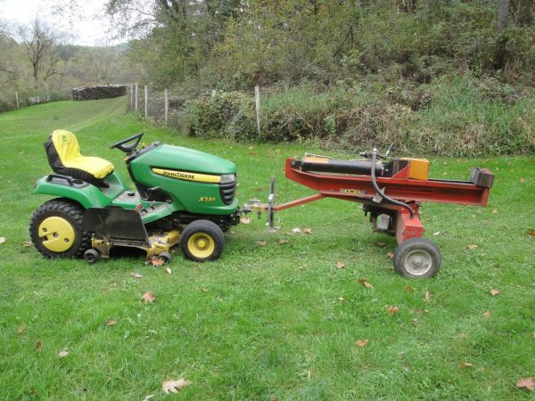

    I have used it a couple times and it works great. Here are a couple pics of it in action.
    DSC03871.JPG DSC03872.JPG Had no troubles pushing it up the hill to the pole barn to park it.

    Ought to be plenty good for the application. I have had one on the front of my 4 wheeler for many years and also on my side by side. I even had one on the front of an old Jeep, years ago. A ball on the front is so very handy, for putting a trailer or whatever right where you want it.
