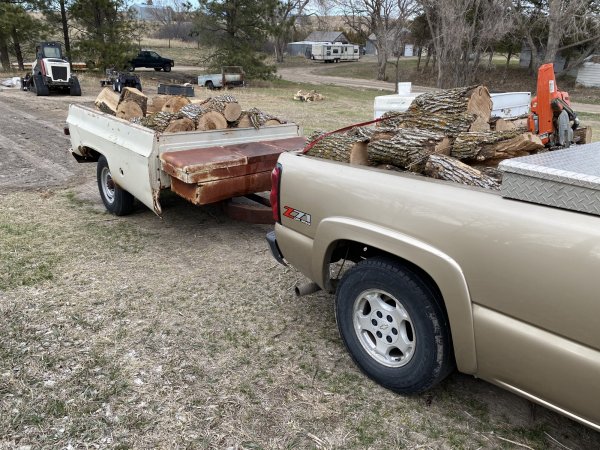

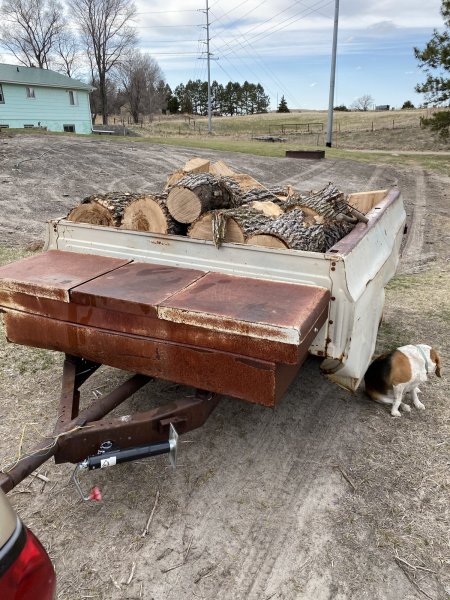

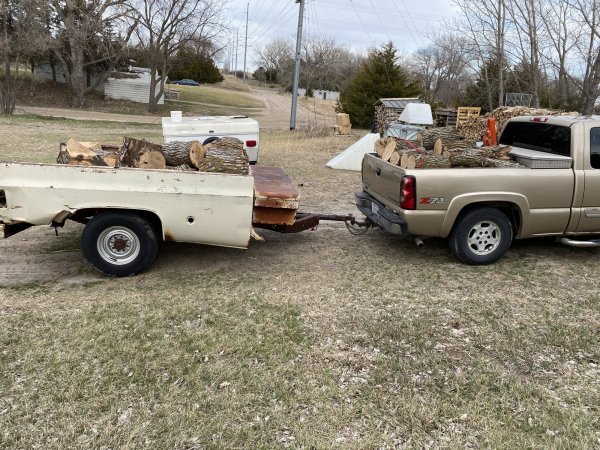

Why not just build a pickup box trailer. You can always add some side boards if you need more capacity. I’d start with a 3/4 at least and a 1 ton would be better. Already got the lights in place this one belongs to the place I work at. Started out as a one ton GM. It’s a little on the ratty side but it will haul a load. Pickup box trailers are very common in Nebraska especially amongst wood burners.
Thats pretty much what I have in mind. Have only seen one of those around here...15 years ago. Cool! Sca
