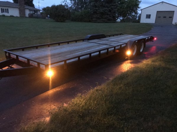

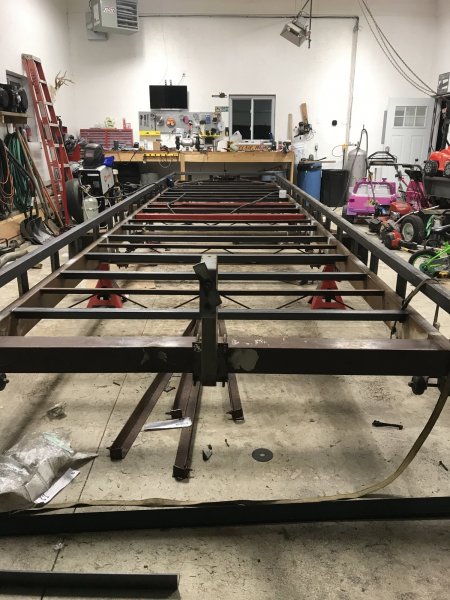

    I decided I needed a trailer to haul multiple sxs units (Polaris rangers). I found that most trailer with enough length were way over built for the payload that would be on it, so I decided to build my own.

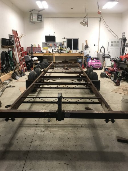

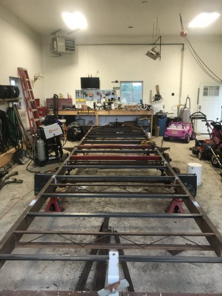

    This started off as a 29” travel trailer. I bought it already torn down to the frame and axles.

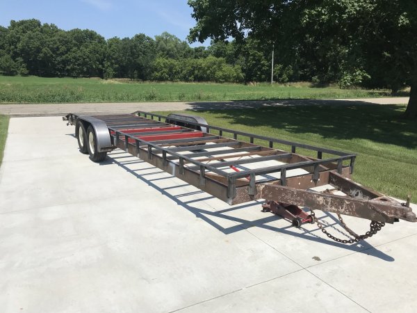

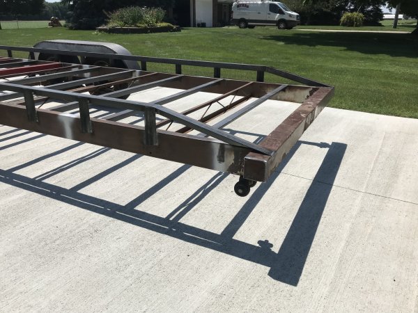

    I added crossmembers and side rails to strengthen it. Finished Deck length is 24’9” and deck width is 70”.

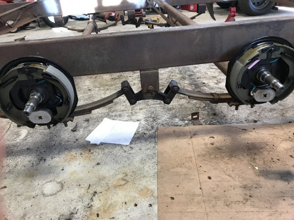

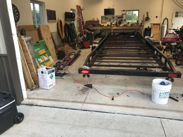

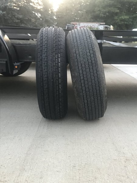

    I added fenders, installed new brakes on both axles, new bearings and seals. Primed and painted.

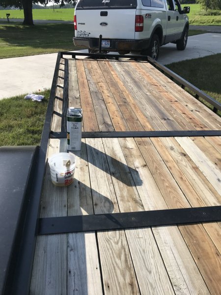

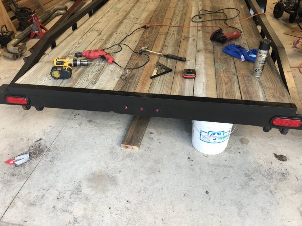

    I added lights, wiring and decking. The decking I predrilled through the boards and into the cross members, then used self tapping trailer flooring screws. I coated the decking with Thompson’s water seal

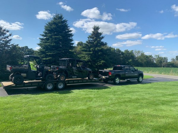

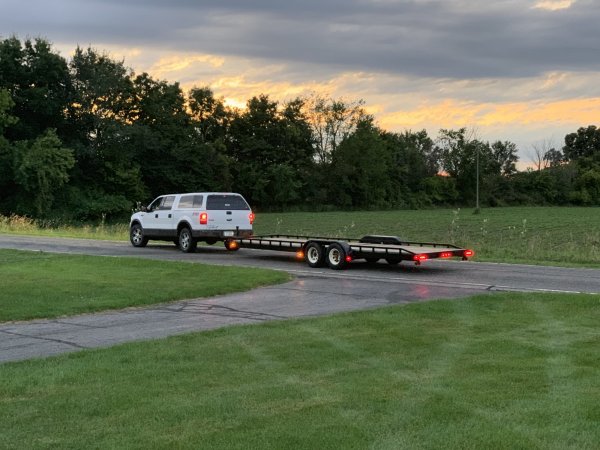

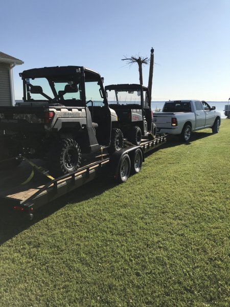

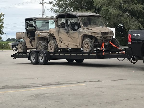

    I added new tires/wheels and weighed it. Finished weight was 2168lbs. The axles are rated at 3500lb each. That allows me to comfortably haul 2 units. It a solid trailer and it pulls great, I’m happy with the way it turned out.
    Last thing to do was put it to use.

    what does a sxs weigh 1000 to 1200 pounds ?
  11. Need2Saw
    Need2Saw
    Apr 10, 2018
    68
    485
    Central Michigan
    Mine is a ranger 1000 with a few accessories and it weighs just under 1800 on the farm scales.
  12. dall
    dall
    Sep 6, 2017
    5,436
    12,069
    West Virginia
    didnt think they was that much
    and a double axle trailer does pull better

    Nice work. Did the Thompson’s make the deck slippery?
