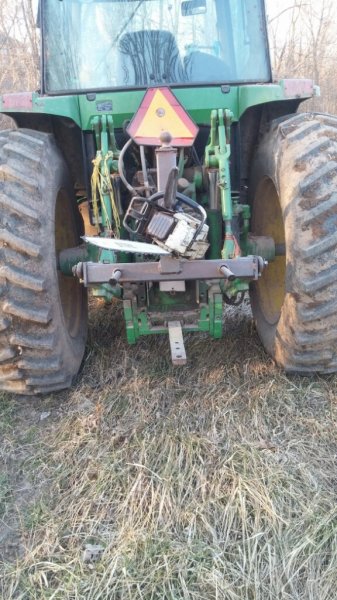

    Pretty safe spot right there. Had one fall out of the bucket once.:emb: it got a little squished.

    I might rethink that carrying spot only because it is easy to back into a tree and mash your saw. The same with carrying it in the bucket...unseen it is easy to forget it is there and dump it out, or go to move something and mash the saw.
    Skidder: On my skidder I carry the saw on the floorboard of the cab, It says on its side, "bar towards the brake" which is the only position that holds it well.
    Tractor: I carry my saw on a homemade wooden box that fits the saw right on the fender
    Bulldozer: I carry my saw in an identical wooden box on the side of my bulldozer
    I dislike scabbards only because a person has to lift the saw so far out of the scabbard.

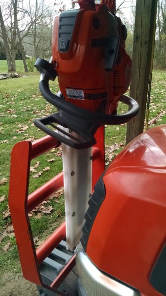

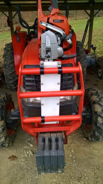

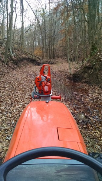

    I borrowed this idea from the googlewebs. Cutting board from Walmart, some stainless fasteners, and a few clamps. It was made quick and dirty, so not factory looking, but it works very well. The cutting board material will not dull the chain when inserting or drawing.
    Just cut thin strips of material and sandwich them between the outer pieces leaving a cavity for the saw bar. I built this one to be able to hold any of my saws, up to a 3/8 24". Only drawback I have found that it is mounted a little bit high. I'm tall, and 1-handed extraction is not easy. Two hands, no problem. The brush guard was a convenient place to mount for me. I'm sure with a little thought, I could find several ways/places to mount it. Previous to this, I carried saws in the small space behind the seat where the "toolbox" is on my Kubota. This is much, much better.
    Edit: Need to mention the top...I added an extra strip of material to make it wider so that the case of the saw is not bearing the load. The spike/s are bearing the downward load. Oh, and leave the bottom open so chips and oil can make their way out.

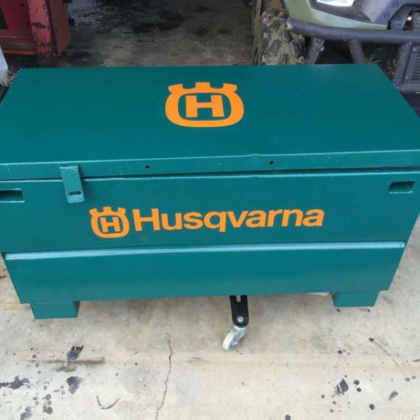

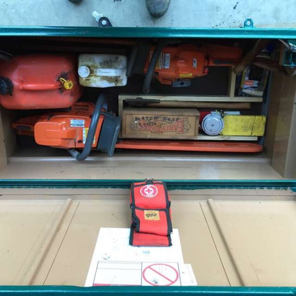

    If I'm going cutting I take the Ranger which has my saw box in the back:

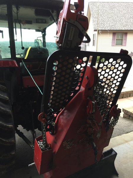

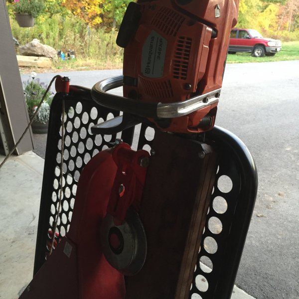

    If I'm taking the tractor out then it's for skidding and my winch is on the back. I made a scabbard similar to RCBS's above, but I used some leftover Ipe decking. Not the greatest photos of it...

    I like the cutting board idea!:thumbs:

    I like the cutting board Idea also. Very neat and clean look to it. The husky box where does it go on a tractor? I can see it on the rear rack of a ATV.

    Nice setup! Jealous of that winch!

    I knew the old pea still worked!:thumbs:
    Great set up RC:yes:

    That box goes in the back of my Polaris Ranger side by side. I stated that in my post.
