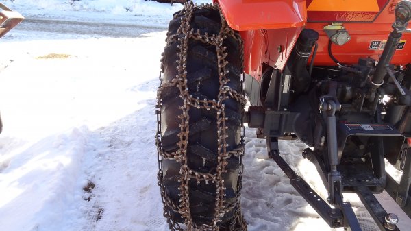

    So up on they go, and then I try to make sure they are centered...

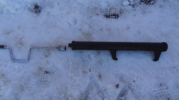

    I'm looking to get that box pattern, above, centered on the tire with the box as square as possible. At this point, I am first tightening around the circumference of the tire, with no regard to the sides. It is pretty handy to have one of these tools, from the same neighbor, to help tighten the chains. I've also used a come-a-long with equal success. This is just a threaded rod with the hook in the center moving toward the hook on the right end as I turn to tighten.
    So the chains are draped over the tire and then the tractor is driven forward to get the two ends where I can work on them. (Note the amount of space between wheel and fender - this was a factor we considered when buying the tractor - it is surprising how little space is provided on some big-name tractors.)

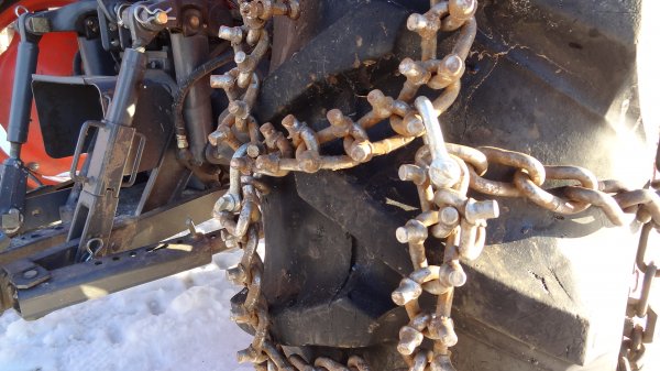

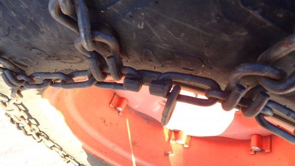

    Now I tighten enough to hold it in place with shackles. There will still be some slop on the front side of the tire. More time is spent checking for kinked links and making sure the box pattern is not a trapezoid.

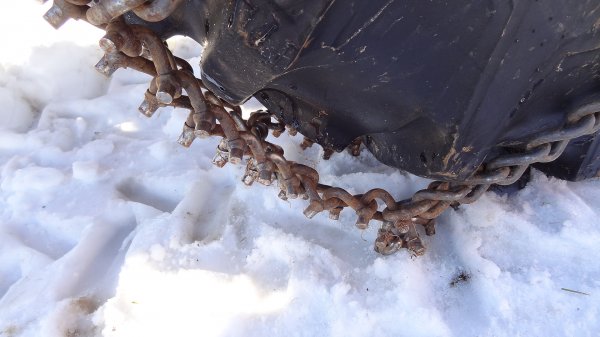

    Despite the nice tool, I still get slop on the front. So I shackle them in place and then drive back and forth. Then the tightener goes back on, and I carefully ease it back and forth (without tearing off the fender or backing over the tool) to work the slack out. As the tires wear over time the chain "lengthens", and as the chain wears it really does lengthen. I have an extra link on the two center chains now - I could cut it off, but instead I just move the shackle back a link.
    The photo above shows the extra link hanging below the shackle. (My box pattern isn't looking too square here, but the end result was good. Note the superficial cuts on the tires - we have a lot of rock, and the chains help a lot with tire wear.

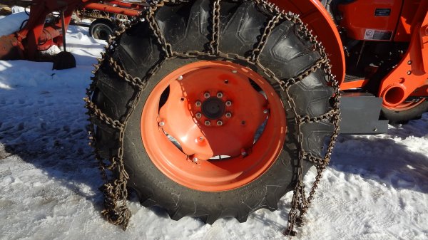

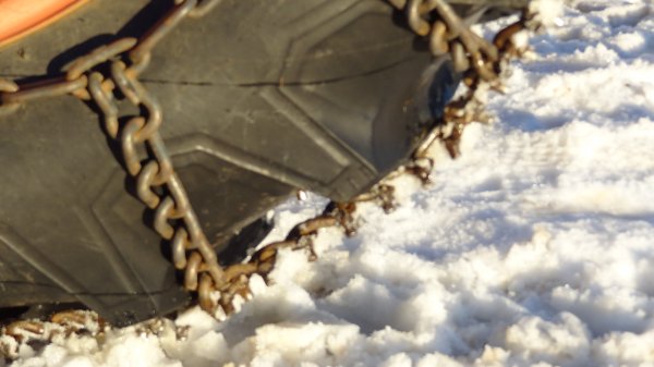

    Now it is time to tighten the sides. These chains have a nice feature shown below. There are several open links that allow you to tighten the side chains over time. These came with a rubber plug tightly fitted in the center of the opening, but obviously not tight enough, as only a few have survived. Fortunately they are not necessary. I could cut this dangling piece off, but haven't bothered. When I am done and driving around, this is the only piece that will make any clinking noise.
    With the sides tight I drive around the yard some and then come back for a final side tightening. Here's how the fit looks at the end of the process. Hmmm. Trouble uploading. Going to post a follow-on pic.

    And here's the final fit.
    The tires are loaded with calcium chloride. I'd like to add some cast iron weights to the rear wheels, but for now I try to have a heavy implement on the back when lifting heavy stuff with the loader. There is a Farmi winch on the back when skidding firewood, but it is an older version that is relatively light.
