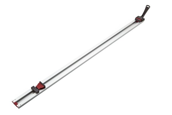

    Pete, are you looking for just a saw guide at this point? I've seen the clamp on circular saw guides for 48" panels. I believe bogieb posted one in a thread once. Almost like a table saw rip fence, but no sled. It seemed to lock pretty positively at the ends, instead of using a few clamps. I believe it was made by Bora, and I saw it at a big blue box store out here.

    The guide I got was from Harbor Freight and I've used the heck out of it using both my circular saw and the little Dremel Saw Max. Works good. The guide goes on sale on a regular basis - I think I got it for around $15.

    I have a Harbor Freight guide but I am after more accurate cuts. I love that guide but it's not as precise as I would like or as easy to set as atrack saw.
    Right now I am after the saw guide and rail.
    I just found one by Bora that has a track an sled! I'm not sure of the quality though.

    I have clamps like these , much harder IMO to set up accurately, compared to the ones with clamps that slide in slots on the bottom .

    I have one of those and I do like it but it flexes to much in the center for my liking. Maybe a better quality one is in order. The harbor freight one is nice but I wouldn't mind an 8 footer too.
