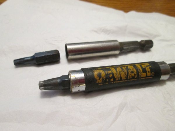

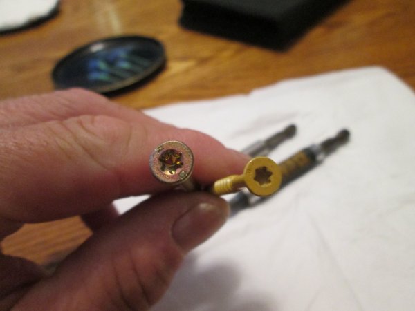

    You can get the little bits that fit in a nut driver. Torx drive screws are very popular in the construction industry these days. I use them a lot. When you buy a box of the screws they give you a free bit. Pictured are T-20 and T-25. Ive never bought any of the "screwdriver" size torx.
    My screnches are the flathead versions. I think i once had an "allen" wrench version of the torx. Used it occasionally on the saw.
