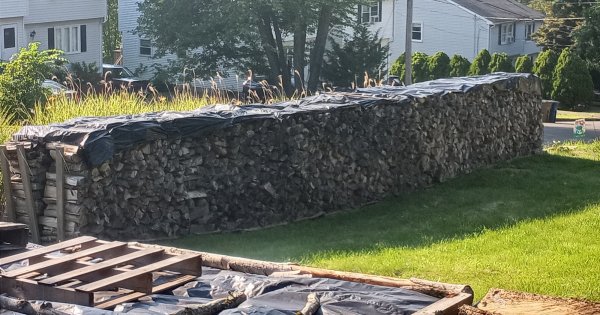

    Somewhere, I remember discussing the top covering I began using, and promised an update.
    Beginning 2021 I began using 6mil plastic sheeting. I buy the 10x25 roll, cut it in half the long way, a 4' and a 6' strip.
    The 4' x 25' strip has been going under the pile, and the 6'x25' on top.
    The 4mil does not hold up as a top cover, even a whole sheet doubled.
    The 6 mil has been holding up much better. After a year it only has slight tears and teeny holes. As we've discussed about oak, it takes a lot of time for it to give up water, and a long time to take on water. So, those teeny holes, the few there are, don't matter too much. I also have been tying paracord over the stacks, as it looks neater than pallets, lumber pieces etc that decorate some stacks. The paracord has a tendency to pull down on the plastic, esp. if it pulls the plastic between logs.
    The only disappointing failure, was the white plastic I used, also 6 mil. That stuff weakened, tore and pulled apart drastically. The black, zero pulls, shreds, tears.
    6mil with lumber, logs, pallets....
    6mil with paracord....

    Most of my stacks are covered with 16mil 6x20, 4x20 waterproof tarps They have been holding up well, but they are spendy. Tried cheaper thinner tarps, but they tear easily and are pretty much ragged sieves after a year. Recently I got some 10mil 6x30 that are a little cheaper, but don’t know if they be as durable as 16mil.

    I use 6mil as well. 10x25' roll. Cut it up to fit my stacks. Lasts about a year but I turn over all my wood each year so it works for me. Tried tarps but they don't last much longer.

    I have been putting plastic on the ground, then pallets. Pallets do ensure circulation, and I assume plastic keeps moisture to a minimum. Not much here is perfectly level, so I don't think there are puddles and lakes under the stacks.
    Far as pallets being good to stack on, i quit using other methods of keeping wood off the ground. Pallets are generally cheap or free, and a row can be added to by adding pallets. 27 cord stacked on those things.

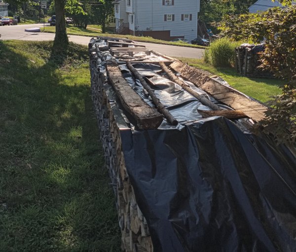

    Another update.
    While the paracord was rather tidy looking, we plastic-topped our latest stack, and weighted it with splits. I initially didn't want to use splits as that is our heat source, and soaking them in water on top just didn't sit right.
    The paracord also cut into the stacks, pulling plastic down in with it. Picture wood stacks with dozens of wedgies. I wouldn't like that either. Next time around, if I ever go back to 4x5.5 stacks, I might find longer poles to run down the top of the stack (2x3's?) and tie against those, so the paracord doesn't cut in and damage the plastic as the stacks move and dry.

    Down here, I could find bamboo. I see it in certain places; where landowners have let it propagate without controlling it, they grow uber tall, 2-3" diameter and they're strong. Think fishing poles gone wild. Those biguns could hold a whale. If you could get real long scrap 1x2's, they would be better aesthetically, as they would weather to the color of firewood.
    I don't like the look of big firewood chunks, splits, tires, whatever on top of covers on stacks. For my eye, a beautiful stack of wood is ruined with that. Uniform splits atop looks a little better; those splits would dry in days in a dry environment if rain gets them wet.
    I always wondered about billboard material. I bought one as a giant tarp and it's thick, very hardy, has the graphic on the front and is black on back. Could be cut to fit. That is, if it's not too expensive.
