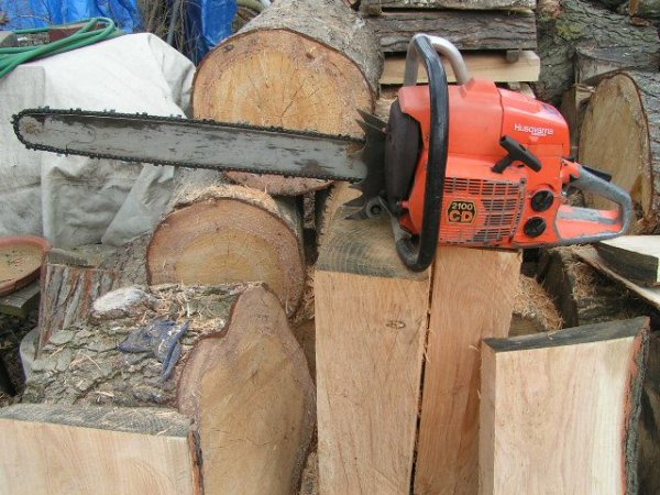

    In April 2013 I was roughing out some White Pine blocks with the 2100CD.I'd lowered the rakers a bit more than usual,works great on softer woods.Imagine my surprise when a few weeks later forgetting to switch to a different chain when milling some large Honey Locust... :eek:
    Pulled it OK of course,but talk about a teeth rattler!! :saw:
