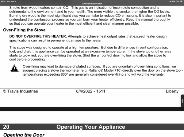

    Some manufacturers still call 800, "generally over firing”
    brenndatomu likes this.
  16. Highbeam
    Highbeam
    Jun 25, 2014
    1,821
    5,685
    "Exceeding 800 is generally considered overfiring and will void your warranty". And then of course there is no hidden temperature disc like you see on rebuilt engines that pop off when you hit 800 so these companies love to void your warranty anytime they think that they can blame a failure on overfiring.
