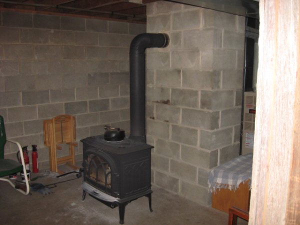

    I got more outta mine today than I normally would on a regular weather year. I blame that on the fact that I have been not burning as hot as I should and am using more soft maple than other years. Before I brushed the chimney I scooped out a soup can full of flakes outta the clean out. I brushed the chimney 4 or 5 times and got a cup full of brown dust. What I don't get is the single wall pipe from stove to chimney. Its the heavy gauge welded seam pipe I bought when I got the stove. 4 feet up to a 90° and 1 and a half foot into the thimble. I always seem to get about 2 cups full of brown dust outta the stove pipe. Nothing that I am worried about starting a far but I would think that should be cleaner than the 20 feet of 6"x6" clay chimney. Excuse the mess please.
    I'm wunderin if I should run a two 45's rather than the 90? The dammed pipe is so pricey that I hate to start experimenting only to find it wont work. As my set up is now I get such a strong draft I am afraid that if I went with two 45's it could get even stronger and make the stove hard to control.
    Oh, in case anyone wunders, those brown stains on the cinder blocks behind the stove showed up after we had an F5 tornado go within a half mile of the place in "08". Kinda drove rain and hail everywhere and it did a helluva job drivin rain down the chimney to the bottom of the clean out. It aint dripping creosote. Just added that as a disclaimer.

    I often get the same results. Excess buildup from the stove to the main chimney. Guessing the smoke hangs out in there a little longer causeing it. I don't know if 2 45's would help. Probabaly just make a lot of holes for smoke to come out. I usually only clean that piece of pipe once maybe twice a year though.

    Brushed mine today and found the same thing. Just a little bit at the top of the chimney but a lot in the couple feet of single wall inside and going through the wall. Maybe RockyMtnHigh could chime in on this.

    Hmm? Not sure lol. My only guess would be that burning smaller more smouldering types of fires the creosote/soot is actually forming lower in the system because it's cooling off faster than usual. Another theory that I've heard is that when you fire up your stove for the first fire of the day etc. you generally have a hot fire as you grow your bed of coals and this helps burn off the stove that collects closer to the stove. I don't have any research or a real scientific reference it's just something I've heard.
    It seems to be directly related to shoulder season burning so I think it's just build up from smaller fires.

    Makes sense lots of starts and stops and a chance for the smoke to hang in that aream
