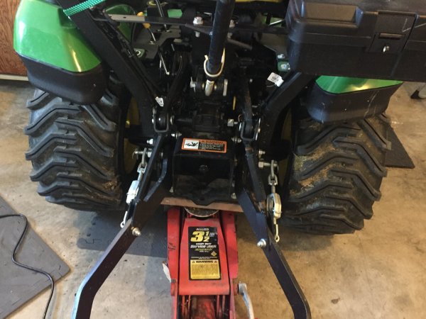

    Got my groove on today grooving my R4's on my 1025R.
    It was actually really easy and the whole thing only took me about 2.5hrs to do all 4 wheels. Should give me better traction for plowing

    Sorry if this is a dumb question, but this concept is new to me. Are you grooving out the 'proud' treads and then putting some sort of plastic insert into the groove? If so, what purpose does the insert serve?

    No insert.
    This allows the tread to cut through the snow.
    The more surface area you have on snow, the less your tire is going to grab.
    You need skinny tread, a skinny tire, sharp tread, whatever.. Tread that works in snow, is tread
    that is skinny and cuts through the snow.
    Best i can explain it..

    Copy that. It's always been my understanding that, unlike mud tires, snow tires have a treat pattern that holds snow since snow sticks to itself much better than any rubber or plastic sticks to it. The reason I asked my question was due to the fourth photo in the post? Or, are those the very neat & clean pieces of removed tire material?

    The more edges you have on snow and ice the better traction you are going to get. By grooving the tire you are doubling the number of edges on each tire to help grab the snow/ice.

    Yea those are the removed material

    That's awesome! What type of tool did you use? Sorry if that's another dumb question...

    I was new to this too just a few weeks ago. It's called the Ideal tire grooving tool. It's basically a soldering iron with a horse shoe like blade on the end that helps melt and cut the tire rubber. I actually got into a community tool pass along on another forum so the tool cost me $65 plus shipping and now the next guy pays me $55 plus shipping to send it to him. New the tool is $85 but I am the 3rd one to use it now, so each guy pays $10 plus shipping for the tool until it's paid off. After that it travels around to the next person at the cost to ship it to them. Pretty cool deal for tools you need to buy to do a specific project that will only be used once.
