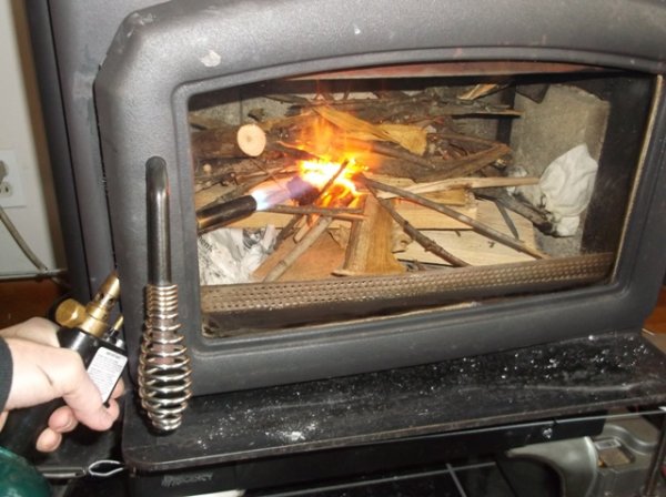

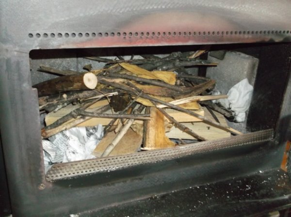

    Here is what I do:
    Some pallet wood on the bottom, plenty of kindling on top of that.
    Place fire starter in middle on left side.
    Preheat flue with torch for a minute or two, light fire starter with torch with door open just enough
    to fit torch in.
    The fire will be blazing in no time.:thumbs:
