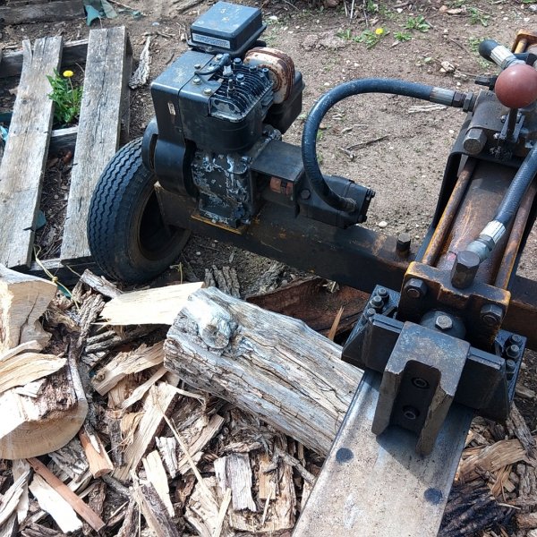

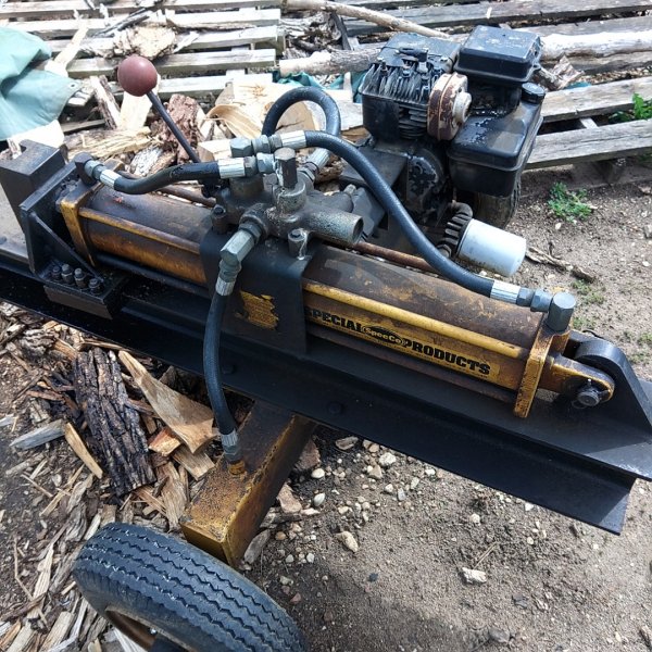

    So I was thinking about purchasing a new splitter but the sentimental value of this one is strong. I remember using lawn money and persuading my parents to loan me money to go to farm and fleet in Sturtevant WI and buy the splitter.
    It came as a kit, all components in OEM boxes.
    All the memories!!
    Time to upgrade.
    Figured I'd start with the pump.
    I looked at surplus center and the 22 gpm and the 28 gpm pumps are on backorder.
    Anyone recommend another supplier that they like?
