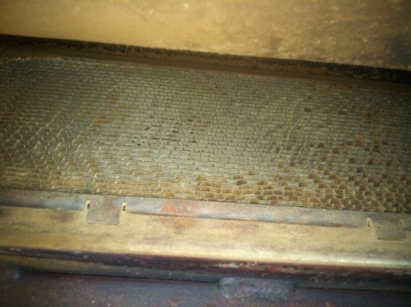

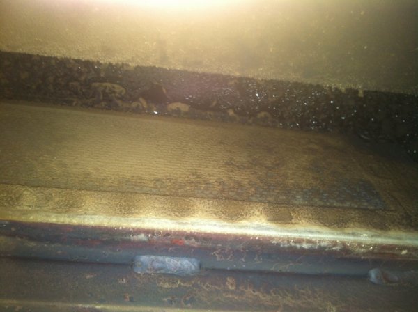

    Stove hasn't been running as good the last week, and last night the load barely burned at all. As soon as I closed the bypass I noticed the fire die down quickly. Knew the cat had to have been clogged up. So pulled the remaining logs, coals, and ash out this morning to let it cool down. The cat was clogged up with light ash and it definitely made a difference. It hadn't glowed at all last night, so I took a little brush and the ash cleaned off easily. With a new load of logs it heated up and the cat ignited right away. So I'm back to happily burning. Here is a before and after pic.

    Wow, what type of wood have you been burning? I've never had my ceramic get any significant build up on it. I plan to pick up a replacement after this season,(4th season on it) I've been trying to decide on ss or ceramic, this has helped to make that decision easier. :)

    It's 3 yr oak and 1 1/2 yr locust. The build up was just very light fluffy ash, not creosote so not sure what caused it. Only on my second year with a cat so still learning. bogydave might have more input, and I should have checked it sooner I'm thinking.
