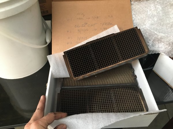

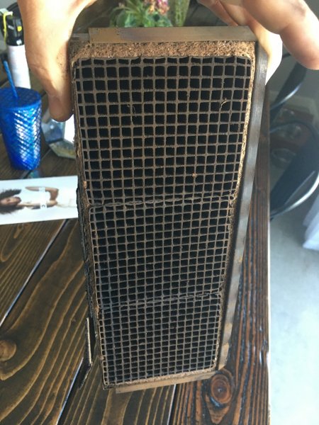

    Since the beginning I have been tracking each cat’s lifespan and this latest one was one of the longest at 20 burning months, or about 12000 hours at low 95% of the time burning softwoods. I believe that burning on low is actually harder on a cat because the cat is doing all the work with no primary flame. The cat meter is always quite high though stove output stays low.

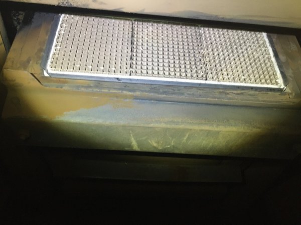

    I am impressed with how easy it is to swap these cats. The new ones are cheap at 230$ and come with a new gasket. My old cats look perfect, no physical damage, but just stop working rather suddenly. This last one would stall at medium thermostat settings.
    I also decided to trash my collection of used cats.

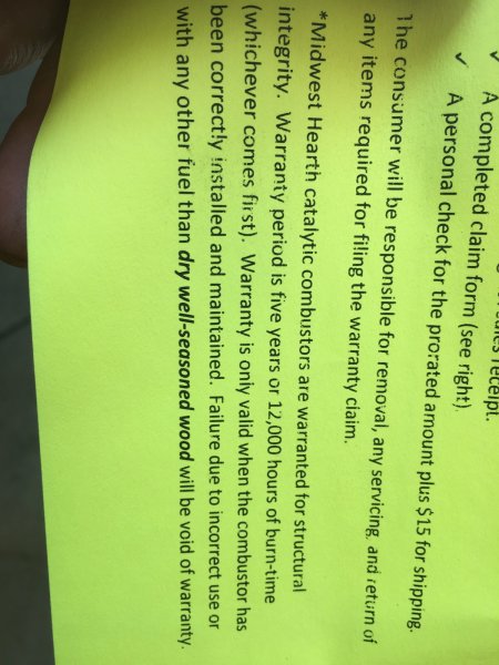

    The Midwest Hearth cat warranty expires after 12000 hours of use which is coincidentally the average I’ve gotten per cat over the last decade.

    Judging by the condition you’re doing a great job at running your stove.
    Can you get a steel cat replacement?
    Have you ever washed your old cats?

    You can see in one photo that there is a dead steel cat in there. It was a BK brand cat and worked just fine but didn’t last very long at all. I do not recommend steel cats. They clog, they cost more, they don’t last as long, and offer no advantage unless you’re clumsy enough to drop cats since they don’t break like ceramic!
    I did do a full vinegar boil on one cat and it helped get me a few more months of life so I keep that knowledge as an emergency tool. Remember though cats are cheap, and the time and materials for that cat boil was not financially positive. Waste of money. The BK design requires that you replace a gasket every time you remove the catalyst so I don’t remove the catalyst until it’s time for replacement.

    It’s 81 in my house. The new cat just stays hot and no smoke. Black box mode. Every dang time I replace the catalyst I kick myself for waiting so long.
