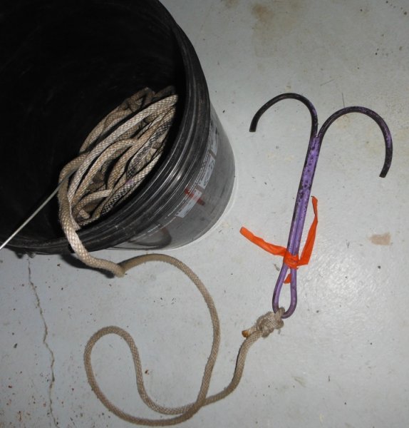

    For the throw weight, go mid range, 14 oz.
    I you need a bigger rope, pull it thru with the throw line.
    I use a grapple to throw up & snag a limb ,
    pull some tension with the atv or pull & tie off.
    The nylon rope is like a rubber band.
