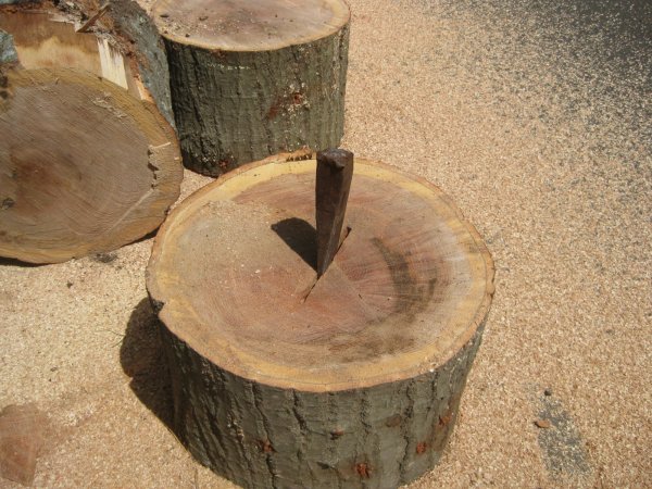

    I go most of the way, roll it 180* and finish with the saw so i dont hit the ground. Sometimes ill go 3/4 way, tip the round on end and split with isocore/X27 etc.
    I have my own "kerf keeper" wedges i make from two by lumber.

    Sometimes ill cut a kerf in the top and sledge and wedge. If the wedge keeps popping out. Usually when noodling is not an option...cutting roadside IMG_0978.JPG
