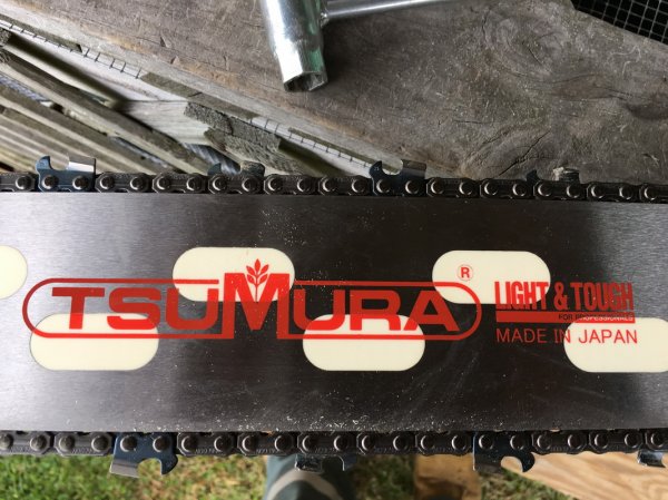

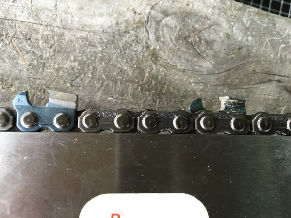

    Square,,,, well, I just got a new 18" bar which came with an Oregon chain he called "Full Chisel and Full Skip". I know what full skip is now, but doesn't this look like a square filed chain?? Whatever it is, MAN does it cut nicely!! I just ran (and recorded video of) a few slices with this bar and chain on my 362 which was just sent out to get MM'd! Will re-do same test on same piece of wood when I get it back to see how she does.

    No, it does NOT look like square filed chain to me...

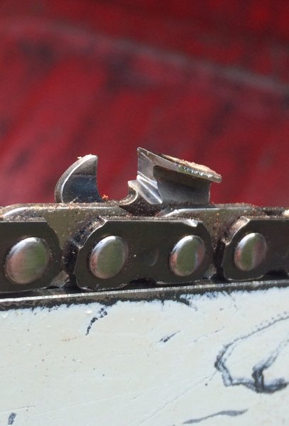

    Full skip full chisel round ground chain can be made to cut very well, but it will dull fast if youre cutting driftwood.
    Here is what a good square cutter looks like

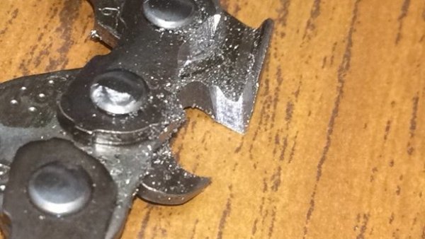

    Here's some dull square
