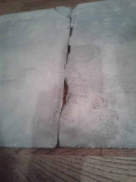

    Anyway just so you understand my stove, I have an Enviro Boston 17oo insert and it uses a set of ceramic baffles with a lap joint to overlay the two sides together making one large baffle. The baffles that came with the stove 6 years ago were so incredibly light and brittle it was green floral foam and a graham cracker had a baby together. So I instantly went on-line to see if there was something wrong like maybe I got a faulty product? However, the testimonies on sites like this were all complaining about hyper fragile ceramic baffles, so it is what it is. Funny, because these baffles felt nothing like ceramic at all.
    As a result I was always very careful with them trying not to hit them with a log or split of wood when loading and also when handling them to remove and replace during a flu cleaning. They only got a few little nicks and scrapes for the first 2 years, but by the 3rd year I started noticing the lap jointed section starting to wear down. On season 4 I started getting small gaps between the boards and those little gaps were growing. I went on-line again to see what it would cost to replace these unremarkable looking boards and I was shocked to find it would cost me $8o plus taxes and shipping ...Ouch!
    Well back in the stove they went as I was now going to use them for as long as I could get away with. So all during the burning season of year 4 I stared noticing more worn off lap joints and the gaps were starting to look like elongated holes. I wondered how much longer they would last, but pushed them to year 5. After the first month of shoulder season burning in year 5 I was noticing something a bit off. I was getting less heat from the stove and less secondary burn. Everything I read pointed to having those holes as the problem. I was thinking, if only I can find a way to stretch the life of these leaky, yet otherwise fine baffles? Is there a light fireproof material, a flat rock that wont explode or piece of metal I can plug the holes with???

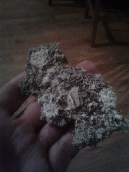

    One morning while cleaning out the ashes from the stove I pulled out a clinker and couldn't help but notice how similar the weight, thickness and texture it had to the baffle, hell even the color! It was also the perfect size and actually I needed two clinkers. Well, where there is one clinker there's usually another.
    So I covered the two holes with the clinkers figuring it couldn't hurt to try, but also wondering how long they will last will they actually improve the burn? What I discovered was they actually did fix the burn issue and they lasted the whole year!
    I was going to continue with it this year, but the the holes were still growing wider under the clinkers and the wafer boards were continuing to grow more flaky and fragile. When I pulled them out carefully to clean the flu in August I snapped the corner off one of them and so I bit the bullet and ordered new baffles that I am burning with now. Incidentally these new baffles that came direct from Enviro seem to be a bit more dense and less fragile so maybe they improved the design.

    This is the clinker I found tonight that reminded me of the one that fixed my problem
    Here is the actual worn baffles that I replaced. I'm saving them in case I need to cut a small piece off for a future repair.
