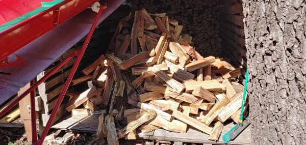

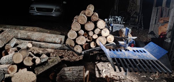

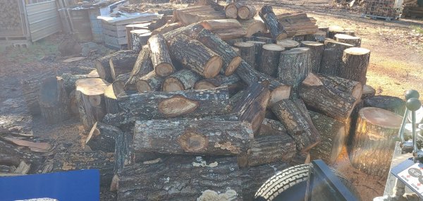

    As Backwoods Savage stated, many variables. Never split right off the truck. We have split with a lot of rounds piled at the splitter, but they were bigger rounds. 0213230915.jpg 0213231231_HDR.jpg
    If we have ~12" rounds, I have stacked all that would fit on log lift~12-15 and 1 pass split with 4-way in 5 minutes or less with Wolfe Ridge 28HO... 0121231948_HDR.jpg

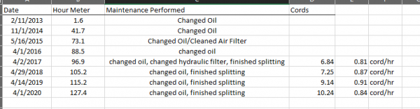

    I keep records from my wood splitter hour meter from when I start splitting to when I am done. My splitter is right next to my to-be-split pile. These numbers include idle time at startup and at shutdown. I only split for ~10 minutes at a time before my trailer is full, then I shut it off to stack. Then I start it back up....rinse and repeat. I split large and I cut to 21" long, so that works to my favor. So a cord for me is a stack 14' long, 5.2' tall of larger 21" long splits. If one is splitting wood 16" long and splitting them into toothpicks, good luck doing a cord an hour.
    My current 9.5sec 40 ton CountyLine:
    My previous 12sec Speeco:
