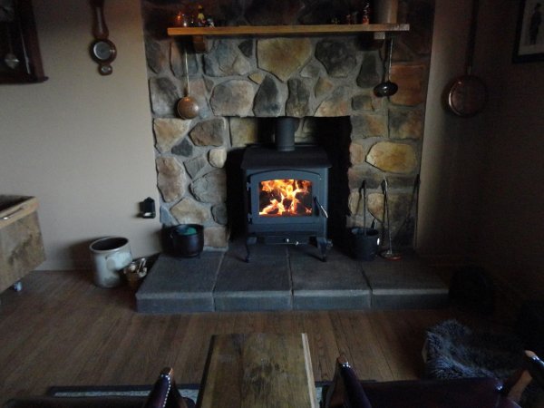

    Much better, night and day better. It seems that I got maybe a third less wood into my medium sized buck, but even if it had been the same size box as the 30, there's no way it would have come close to providing as much usable heat. This being my second season with the stove, I'm hoping that I've learned a few things to get even more out of the wood.
    One from last winter.

    Thats nice, Norky!
