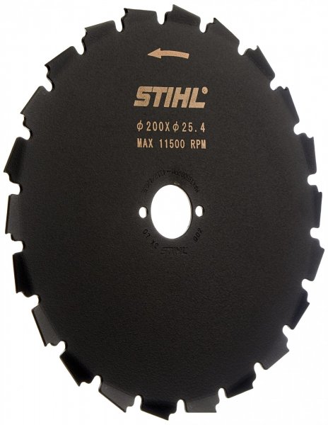

    Don’t overlook the FS111RX, the 131 is what I wanted, but they didn’t have one in stock, the 111 with brush saw blade is almost impossible to bog down. I was even lowering cedar stumps that were left kind of high on my shooting lane.

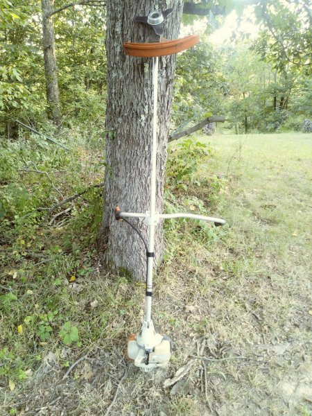

    Maybe altogether I keep down about 1/2 acre of deer paths and a couple areas. I only use it where the tractor won't go or where the ground/brush would tear up the mower or get stuck.
    I use the tri blade. Keeping the blade sharp makes a world of difference. I keep one spare sharp one in the shed. If you keep the throttle hammered down the 4 mix will eat it. You'd have to do something really stupid to bog it down or wrap grass or string around the head.

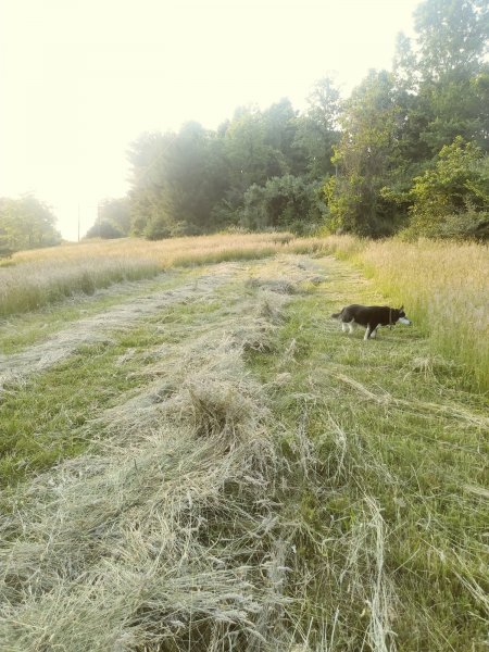

    I also was goofing off this summer and made some hay with it.

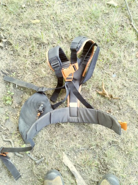

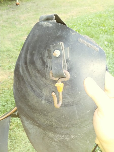

    If you are set on the handlebar brushcutter see if they have this version of the harness for it. I broke part of the harness that hooks onto the cutter after 5 years of hard use. I went to buy a new harness and the one they had at the hardware store was a cheaper less supportive version and it was way over priced compared to the one I got with it. Rigged up an old serpentine belt and nut and bolt to fix it. Good as new.

    That's awesome....the hay making I mean.

    The FS111RX is a no-go with a brush blade - RX models have hollow driveshafts, and usually a special gearhead built to be lightweight. It'll likely be ok for just grass and Goldenrod, but the first bump into anything tougher is likely to invite trouble in the form of a broken driveshaft.
    The FS111 or FS111R would be fine with a brush/grass blade though.
