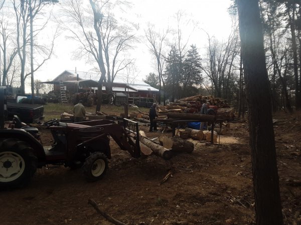

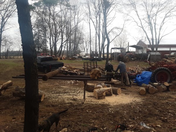

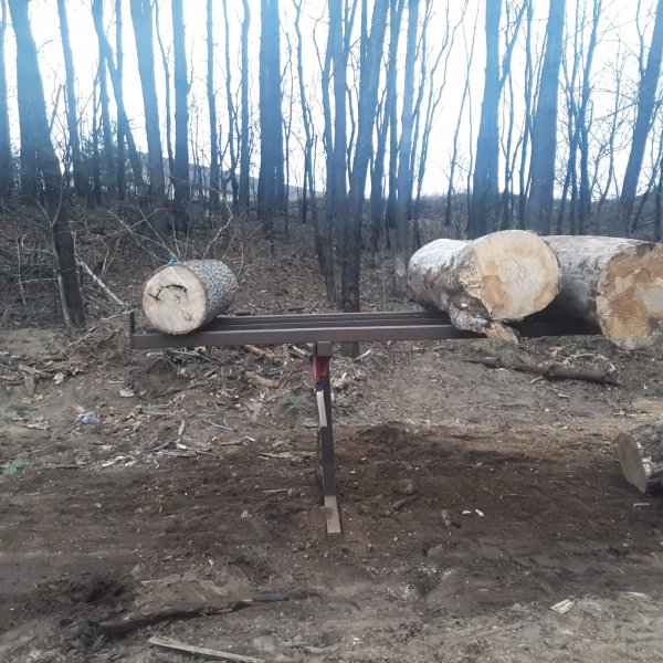

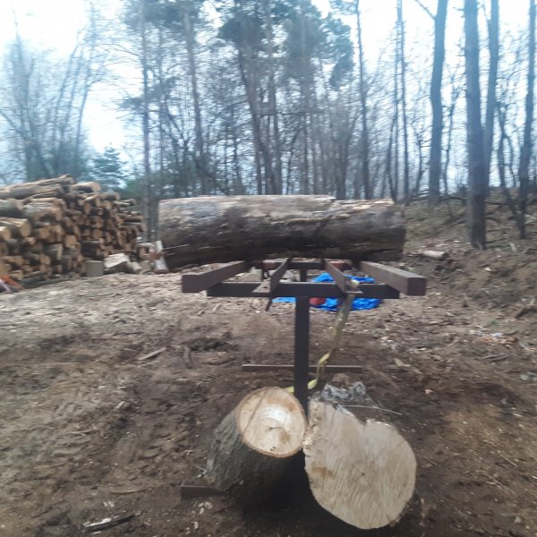

    A few have asked about my big sawbuck. I dug it out & set it up tonight and put a few logs on it before it started raining. Pretty self explanatory in pictures.

    I cannot tell from the pictures. Is it made from metal or from wood.

    Looks like angle iron and square tube, to me. It ought to hold up, OK. Just need to be really careful not to hit the steel members with the chainsaw.

    It is steel, very heavy construction.
    If you look at the spacing of the beams, there's ample room for the saw to drop through without coming near the rails. In the first pic you can see the distance to the first support, that's 42". The beams are spaced so as to able to set an 8' or 12' log on center & cut 18" or 24" rounds & not come close to the steel.
    Ha! Yep, that ain't gonna happen lol. I load it with the tractor & then buck the full load of logs. The splitter is set about 10' away, the rounds drop & get rolled to the log lift, split & then loaded into a tractor bucket or run up the conveyor into a dump trailer depending on where they're going. The conveyor isn't set up yet as it started raining. I gotta drop that into place yet. This is a new processing layout so I'm sure some refining will be necessary.

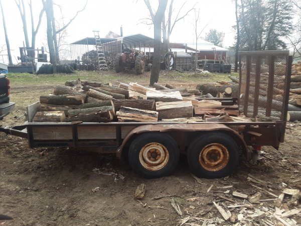

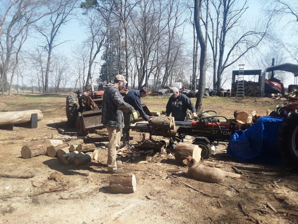

    Here's a few pics from yesterday of the processing set up. Conveyor not needed yet. We made about 2 1/2 cord in 3 hrs. 20210403_085908.jpg 20210403_091948.jpg 20210403_085932.jpg 20210403_122456.jpg

    Yes, we loaded Ken's trailer, made about a cord for me & then about a cord for bundled campfire wood. That takes forever making those little splits. Feels kinda like making toothpicks after doing boiler splits. No, we didn't work real hard lol, just enjoyed a nice day.
