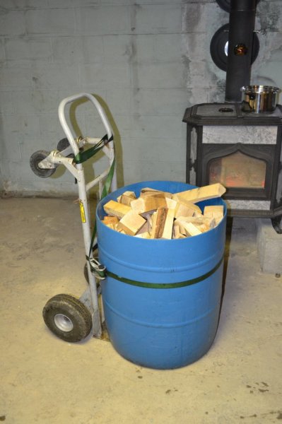

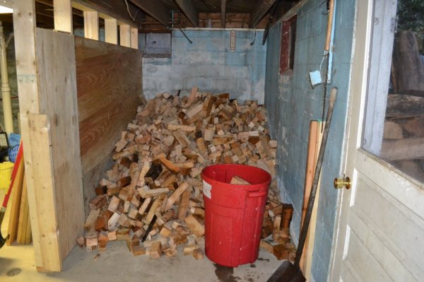

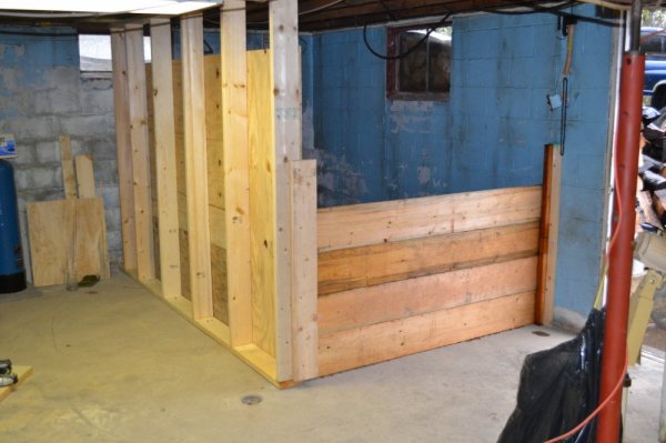

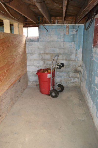

    Spent the last couple days building/filling a storage bin in the basement(dungeon.)
    10'x6'x6' with removable end gates (2x10 planks just sit inside)
    Put a load of kiln dried Oak wood in it. About 1 1/2 cords. Wood comes from a local furniture manufacturer.
    Wood is 3"x3" and 3"x4" and ranges from 2-12" long.
    When I reload I've been throwing a layer of these on the bottom and a locust split or two on top.
    The kiln dried takes off real fast and the locust burns nice and slow.

    Looks sweet. Big storage and easy to clean out.
    Woodsnwoods likes this.
  3. bogydave
    37,217
    WOW!
    Looks great.
    It's huge
    You are gonna love it :)
  4. BrianK
    BrianK
    3,098
    11,067
    West central PA
    Nice. Looks like it will hold another load or two?

    Notice you have a Fireview in, what appears to be, an uninsulated basement. How's that working out for you?

    Well...not as good as i had hoped, but it is keeping the house up to temp so far. Although it hasn't been real cold this week. I turned my oil furnace off Monday when I fired up the wood stove and I am going to try to keep it turned off thru the next cold spell. I am really firing the wood stove hot tonite to try to warm the house up after letting it cool down today. If I need to kick the oil furnace on occasionally to keep the house comfortable I will, but I hope the Fireview will keep up.
    The second floor in the house is the coldest part. The house is a cape cod with one big room on the second floor and it never did get warm enough even with the oil furnace. I think the heat ducts were undersized and there was no returns. Just what flowed down the steps. The insulation isn't good either. So it will be a work in progress to see if I can get it figured out.
    When I get the new duct work in (I just replaced the oil furnace) I want to try cutting in 2 or 3 returns right over the wood stove and running the blower on low to see if it will spread the heat around and pull the heat away from the wood stove.
    That's the one thing I never liked about a wood stove. When your in front of it, your too hot and when you go to the next room it's not warm enough.
