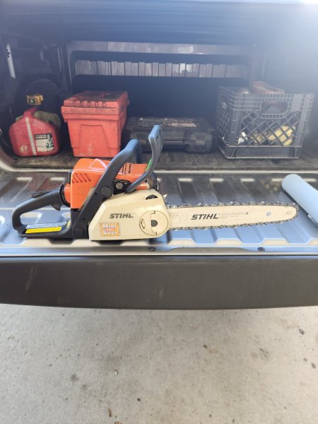

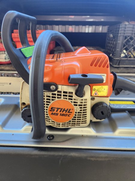

    So recently ...I searched high and low...found a replica ...with the Mini Boss sticker and everything !

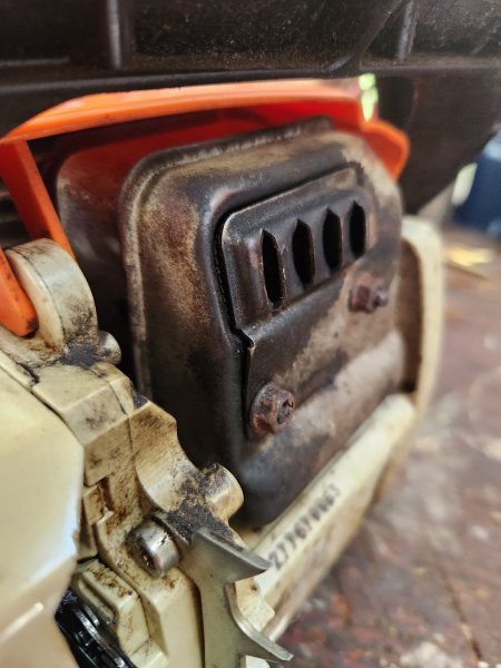

    I got her all cleaned up...muffler modded ( muffler holes ground out completely...exit louvers pryed open more )etc. This thing was hardly used at all. Great 14" bar and chain.
    I forgot what a light weight gem these saws are. I'll never be without again ! Feels right at home in my hands :)
    Nice to get some things back.

    If you want more power, a walbro WT-15 carb for an MS250 fits and is fully adjustable.

    Would be nice to be able to richen up the top end a tad ..thats for sure.
    This is on my to do list this winter...thanks !

    You have to plug a pulse hole on the new carb, if I recall. YouTube will show you the way.

    So what really stands out here for me is the oil tank window. IDK if I recall seeing one besides the one on my battery powered makita. Kinda hard to do with a metal case, but this is something at least all clams should have.

    Nice saw. We have one without the sticker. Did muffler mod like that, it really cuts, and has the oil tank view slot, IIRC.
