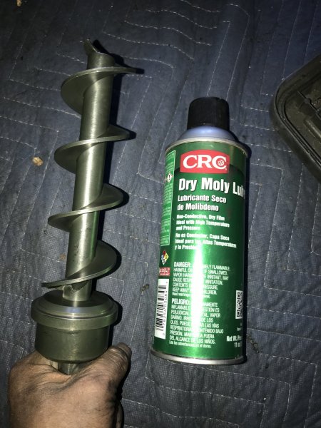

    This is an 11 year old Harman insert with all original parts.
    This is it! Removing the auger and wire wheeling the Auger and Auger chute and installing a brand new auger motor did nothing to change that wicked loud squeal! Just listen to this!
    What to do now?

    Took the auger out and wire wheeled it and spray lubed with dry moly and absolutely no change!!

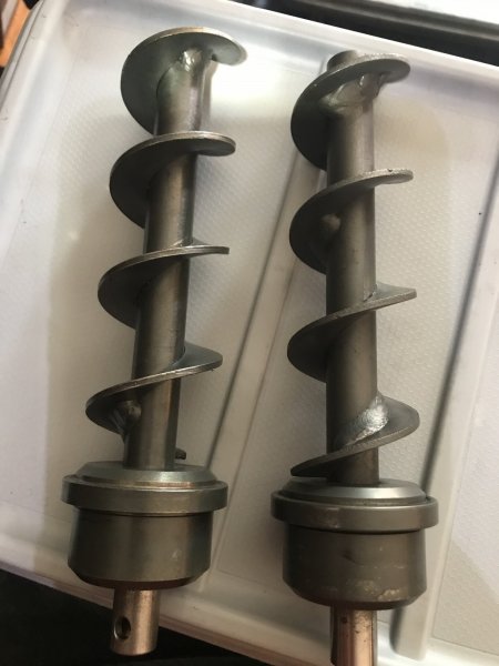

    There is a big sealed bearing on the back end of the auger and when I spin it by hand out of the stove, I hear a slight clicking noise.
    However it can also be the fact that the fins are not thoroughly welded on to the shaft and when it expands when running it the hot stove and rubs very slightly against the inside of the auger tube, the frequency it rubs at creates the very high pitch whine.
    The new augers have 3 big long welds on the fins so when I pull this one again, I will compare them.

    The new auger has slightly smaller diameter fins and 3 weld spots with an extra one in the middle instead of just 2 at each end that the original auger has!!
    The auger bearing is nice and quiet too.
    1st pic - new auger on right and old auger on left
