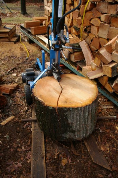

    Worked on some of these this weekend. They split like a hot knife in butter with a 16 ton splitter once I figured out how to jockey them into place and align the crack in the round. Rolling them up and plopping them over onto the splitter was hit or miss. Took a pickaroon to twist them to align the flaw with the wedge and a pry bar to get the round tight up against the beam. Once I did that they popped in half and my prybar could finish off a few hanging splinters. No noodling at all.
    25-35 splits per, depends on if I was making 6x6s or 2x4s. Might be a PITA to get the round into place for the first split but once that is done they certainly stack up fast.

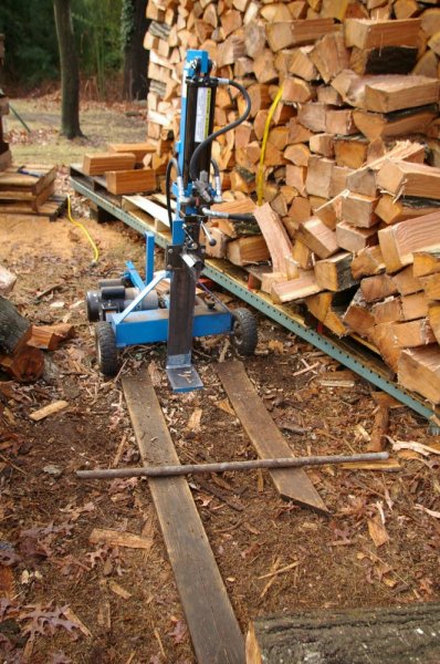

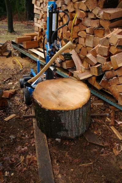

  15. Paul bunion
    Paul bunion
    3,378
    13,320
    Pipe sounds like a great idea. I have some old 2" pipe that might just allow me to not even need the plywood. And multiple pieces might make it real easy to slide the round in.
    I'm using 3-4 cords a year in an insert burning 24/7 when it is cold enough. Can't do the house 100% due to the layout but I can keep the gas bill at or below $120 in January, summer gas bills are something like $35. This wood will be for 16/17 and possibly the last sticks will make it to '18. All depends on how cold it is. The way this year is starting out it will on the longer side.
  16. Scotty Overkill
    9,614
    64,517
    Paul, those big rounds are by long and far my FAVORITE firewood to process and stack. Lots and LOTS of splits in one round.
    Yes, wrestling them around can be a hassle, but worth it in the end. I really REALLY like Oliver's suggestion of the pipe and plywood for maneuvering the rounds into position.....something I may try myself when I start splitting up all those monster sugar maple/red oak/white oak rounds sitting at the processing area right now....
    WeldrDave likes this.
  17. Paul bunion
    Paul bunion
    3,378
    13,320
    I split up another 6 or so this morning. Without any exaggeration the pipe trick makes it about 10 times easier to get the round jockeyed into position. Incredibly easier to move and position the rounds with a little roller beneath. Thanks Oliver.

    Paul Bunion. Is that an electric splitter? 16 ton? 20 ton? Ramsplitter?
  19. Paul bunion
    Paul bunion
    3,378
    13,320
    16 ton Ramsplitter. Electric.
