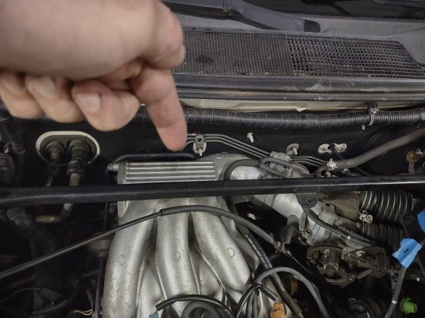

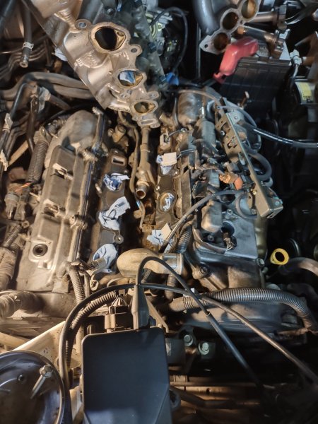

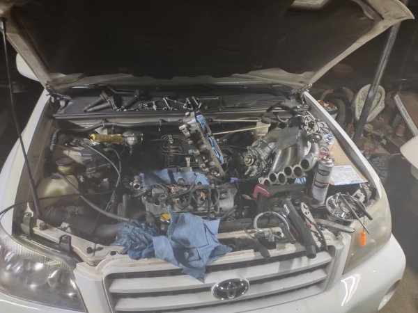

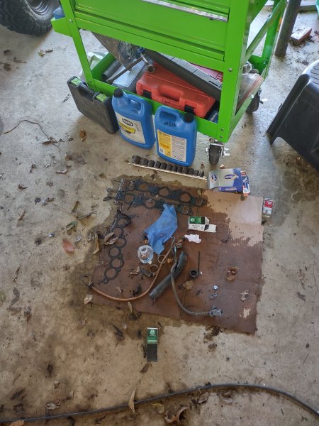

    This year's was the Highlander. It had either a bad knock sensor or bad wire harness for the sensors. The whole intake has to come off because it's below it. So while your in there you may as well replace both sensors and the wire harness because the only way to get to them is once you pull the intake. While you there there is a coolant bypass hose that has to come out and it should be done as well. My valve cover gaskets have been leaking for years so I planned to do them as well since the only way to do the back one is with the upper intake pulled. And I put the back three plugs into it since the only way to do them at least for me is to pull that upper intake. If you were paying someone you might as well replace the coils as well but I rolled the dice and just reused the originals as there fine. I have an extra upper intake gasket and have gotten pretty fast at it by now so if they go bad I will just replace the coils then. Now for some pics.
    The valve covers leaked so bad that it always smelled like burn oil from it running down onto the exhaust manifolds. The check engine light was on. The code was that the PCM couldn't see one of the knock sensors. It's either from a bad wore harness or a bad sensor. The engine reduces timing when this happens to protect the engine so it won't knock . Also it keeps it out of overdrive. When I first cut it on, it will go into OD but if I come to a stop it will not shift into OD. So I was having to cut the car off and back on to get back into OD. Usually this was done while moving, hitting neutral , cut engine off and back on then shifting back to drive. I live in a rural area so I could get to work often without even turning it off as I never came to a stop. But when driving in a city or on a trip it got old fast. I ran it like that for months.
    Side note. As much as I like Toyota there are 4 bolts on the back of the intake. Many of them I believe could have been relocated to an easier spot to access.. three of the bolts really are not hard of you know where they are. The fourth is hard because there is not room for a socket or a wrench due to the firewall and a flange on the bracket. I was able to get to it with an offset box end reaching one hand under the intake and there other behind it. IMG_20221127_171322758_HDR.jpg IMG_20221124_155338208_HDR.jpg
    This third pic you can see the knock sensors down in the intake valley in the center. They have the wires running to them. IMG_20221125_173936792_HDR.jpg IMG_20221125_192648789_HDR.jpg IMG_20221127_151300769_HDR.jpg
    Well it's all done, back together and check engine light is off and drives well.

    The cost of the parts for this job was close to $400 alone. Glad I don't pay someone to do this stuff!! OUCH!

    That was with me buying NTK knock sensors ! If I bought Toyota sensors those two alone would have been $500 not sure what a Toyota brand wire harness costs. The NTK sensors were about $115 a piece. Put a gates hose and standard motor harness in there. Put Denso iridium plugs in. The Felpro intake gasket set is like $65 . Like $40 of red Toyota (aftermarket) coolant. I got the best aftermarket sensors my research told me and a respectable name in Japanese vehicle aftermarket/OE parts to put back. With the work involved with getting in there I wanted to make sure potential parts failures were at a minimum.
