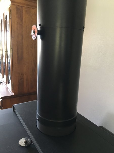

  5. Highbeam
    Highbeam
    Jun 25, 2014
    1,887
    6,030
    I’ve installed in the overlap section, it’s actually 4 layers. Not difficult at all. Added near zero effort. The problem with it is now the probe holes must all align whenever you collapse the section for removal. Which really shouldn’t be a problem unless you swap stoves or change your hearth.
    What I’m saying is go ahead and lower it an inch or two to stay out of the overlap but don’t be afraid to put it there if you must.
    My current probe install is just below the overlap.
  6. Highbeam
    Highbeam
    Jun 25, 2014
    1,887
    6,030
    Since everyone likes pictures. Just under 18” above stove top.
