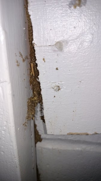

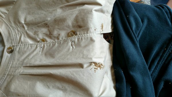

    I was going through some clothes I have not worn in a year or so, they are in my closet which, side is concrete block, back is concrete block.
    After seeing my jacket in the pic, WWW found the gap between an 2x4 and the concrete wall for the closet frame, it is full of .....dirt? dust? poops?
    Are these termites? Since when do termites live in Colorado or Wyoming?!?!?

    I wonder if they are carpet beetles? I believe they eat natural fibers. Nuisance insects. Any brown worn looking carcasses? Holes in the clothes?

    I am not sure what they are, you think the carpet Beatles?

    YES Jon, I am so grossed out, tons of lil husks things. My question is, should I see lil carpet beetles?

    I've seen them in dresser drawers, in between sofa cushions and on window sills trying to get out.
    That picture I put up is not that great, but it showed different stages of development.

    It dont look likes white ants or termites.

    Thank You! I've never actually seen termites before. Phew!

    :doh: I think they are termites :picard: I finally got a pic of a hidden corner, those nasty buggers are already exploring. I think the yellow color is (was) expanding from he used to seal up the bedroom in 2013. The other pic is part of the closet frame against the concrete wall.
    So what do I do now? Bait? Poison? Bug bomb?
    Brain storming, I could run around and drill holes in the floor in all the rooms in the house and get stuff under the house that way? (living room ok, have trap door in floor for cistern).
