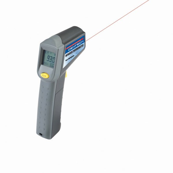

    We also have one of these:
    We do check the magnetic thermometers from time to time using one of these and so far, so good.
