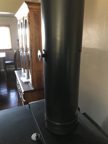

    This is why I do not like removing pipes for maintenance. What happened is that you shoved the tapered end of the pipe tighter into the stove. The only other possibility is that the floor settled under the stove.
    You should have also had three screws that locked the telescopic section in place. Those screws, just like the probe hole, should have not been aligned.
    When you replace the pipe, install the probe outside of the overlap to prevent the probe issue but you still have the screw issue.
    Here’s mine just under the overlap.

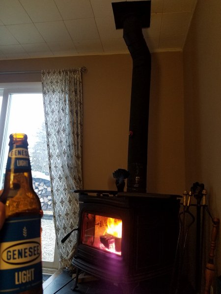

  15. woody5506
    woody5506
    Nov 28, 2017
    1,086
    5,931
    Upstate NY
    Just so happens I'm sitting right in front of it....

    I'm assuming it's not as goofy looking as I may have made it out to be, lol
