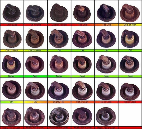

    Spark-Plug-Reading-1024x933.jpg I should make a rule to never post after bedtime, but at least I didn't lead you down the garden path. Red hot exhausts aren't visible until it's full moon dark or darker, if the engine is operating properly. So there might be nothing wrong with your engine. You set the Marvel Schebler carburetor on the old tractors by running it at high idle, turning the high speed jet screw in until the engine lost a few revs, then backing it out a half to a full turn, depending on how much you were willing to risk burnt valves. Pretty blue flames are a sign you're too lean if you're under load, but probably not if you're at high idle. Pilots flying the old radial engines at night would lean out until they saw blue flames when they reached cruising altitude.
    Spark plug condition can tell you a lot.
