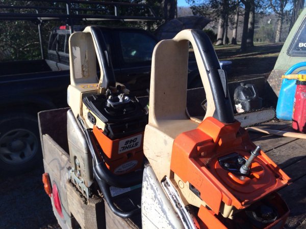

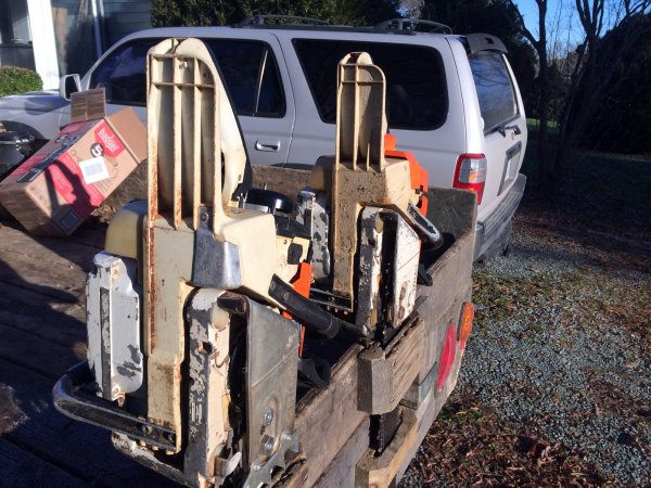

Ok, we are finding out that 046 fuel tank/back handle assemblies are kinda like hens teeth hard to find. Does anyone have a useable one they'd sell me? Mines busted right at the "crotch" at the tail of the handle. I've rigged it to be useable, but I want it fixed properly. One other possibility is this...will an 044 tank assembly fit the 046 motor? Because I can go that route if need be. Has anyone out there tried this swap?

The tank housing/handle assy. #1128 350 0845 is only used on the 046. The 044 part number is 1128 350 0844. Maybe the aftermarket company figured a way to make one that fits both.
They all have flippies now.. My 10 mm 044 has a flip tank. Hutzl would make a fortune if they made a screw style cap for the 044. I looked on eBay, I thought there was an 046/460 tank. But it's only the 044/440. Sorry Scotty. There is several used tank on the Bay though. Not terribly proced
I've never tried this, nor have I spoken first-hand with anyone who has, but I've been told that if you swap the two pressed-in carb mounting studs you can use an 044 tank housing for an 046. Anyone else ever heard of this???
I think you can use the 440 tank. It's just a touch narrower and holds less fuel. The plastic doesn't line up correctly afterwards either on the filter cover. I've seen pictures of saws made with all the different combos. I would just keep an eye out for a used 460 tank. The 046 tanks are getting old and the new tanks are better plastic.
