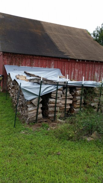

    Apparently my photo didnt load from my my phone so here it is. Ive been doing the tarp thing for years now and was hoping to build a woodshed this summer but it just didnt happen. We had the house painted, got a new HVAC system installed and worked on countless other projects and the shed just kept getting moved back but hopefully next year will be the year of the shed.

    Matt, you have some nice wood piles but this scares me a bit. The reason is water flowing off the barn roof and then immediately a low spot on the wood pile. Hopefully one side of that pile is a lot lower than the other so water can flow off the sides. Otherwise that could prove to be a big problem. I see other low spots on the pile that also could be problems. Better to have a high spot in the center so water can run off both ends or one side of the pile a lot higher than the other to run off the sides. Then, of course, you have to be sure the water does not run onto the wood as it runs off the top else wood will get waterlogged. Not a good thing. Hopefully you have some plans on this or the pictures also can be deceiving.

    Yes I do have a to get out there and tweek it a bit. Ive got some more wood on the other side of the barn that Im going to put in there and Ill probably also get some 2x4s or something to prop it up a bit. I dont like the way its hanging on the front of the stacks so Im going to work on that too. Im planning on getting to that on Thursday after work so I should have a slightly different picture up then. Good looking out there Dennis:thumbs: much appreciated advice.

    Well the tarp is gone for now. We had a pretty good storm last weekend and it got blown over and filled with water:picard: So I got it off and am going to leave it off for a while so that some sun gets down in there to help dry things out. When I do put it back on Im going to lay some lumber across the stacks and use string to tie the tarp down instead of the tie wraps that I had in place before. Oh and I leveled the stacks out some too so hopefully that will help out .

    Good lesson learned and just this once getting wet like that won't ruin things. For sure when you redo things, get the stringers or plywood under the tarp and not on top. Also, with tarps I've found that it is usually best to not try to get the entire thing weighed down. If it is just a slight bit loose, the wind can get under it to dry the moisture that gets through or the moisture that still comes out of the wood. Now if you just had those 4 x 20 sheets of steel roofing that ID1 gave away...
