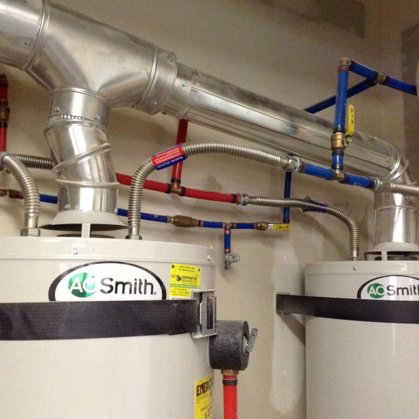

    So this is our set up image.jpg only had cold water when every one was home for the holiday's.
    wildwest likes this.

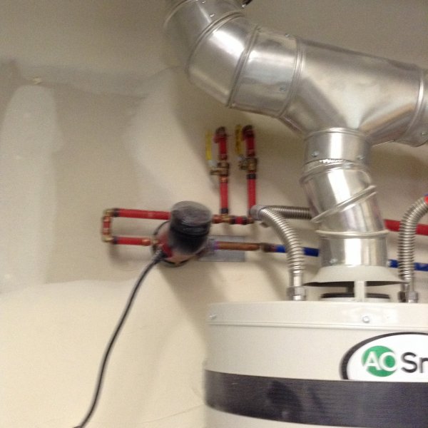

  7. WaddleRemodel
    WaddleRemodel
    Nov 23, 2014
    750
    2,995
    Southwest Wyoming

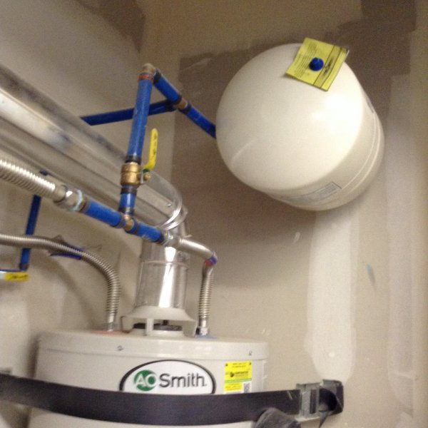

  8. WaddleRemodel
    WaddleRemodel
    Nov 23, 2014
    750
    2,995
    Southwest Wyoming
    image.jpg Right side.
    MasterMech, smoke show and wildwest like this.

    Waddle, does one heater feed to another before going into the house? Or are they both set at hot water and feed simultaneously?
  10. WaddleRemodel
    WaddleRemodel
    Nov 23, 2014
    750
    2,995
    Southwest Wyoming
    They feed the same. Basically we have 100 gallons of hot water. In the last picture we added a recirculating pump set on a timer. Instant hot water to shower and sinks.
