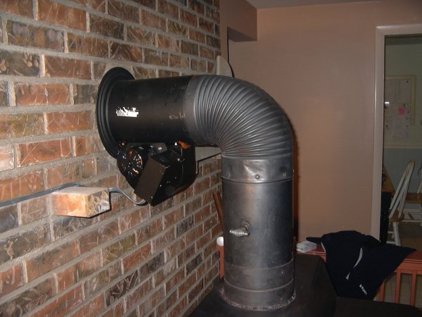

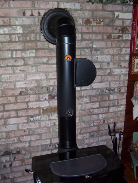

    Nope, you do not have to run the inducer vertical. The instructions show both vertical and horizontal installations. The only requirement is that the draft inducer be put under the horizontal pipe, so it runs cooler and does not overheat.
    Brian

    Couple of photos of vertical and horizontal installs. Both work just fine. Neither one is my stove, just some photos I grabbed from the 'Net.
    Qyota likes this.
