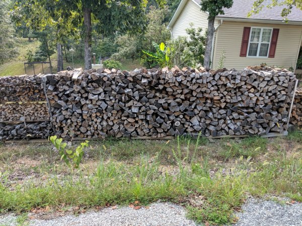

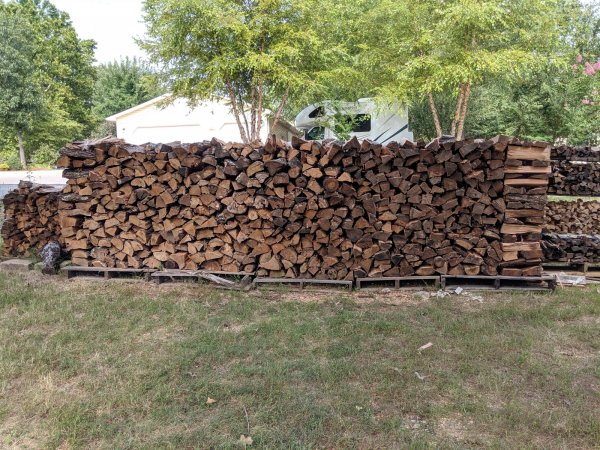

    I sell a little over a cord of wood each fall to help off set saw fuel and maintenance costs. Here is 4 face cords/ric of wood stacked within a couple of weeks of each other. One side gets direct morning sun and the other is partially shaded through the afternoon.

    looks like nice stuff and ready to burn. Id buy that in a heartbeat!

    So, they are a different color which really does not tell anything. Wondering what your point is?

    Without a moisture meter check, that is true. I was just pointing out the weathering of the full sun side versus the non full sun side.

    Funny but I've had sides like that even when both are in the sun or both with no sun. Perhaps rain makes a bigger difference than we think sometimes?

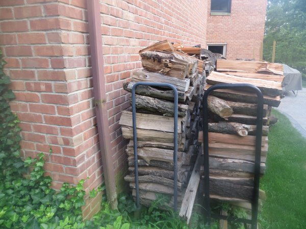

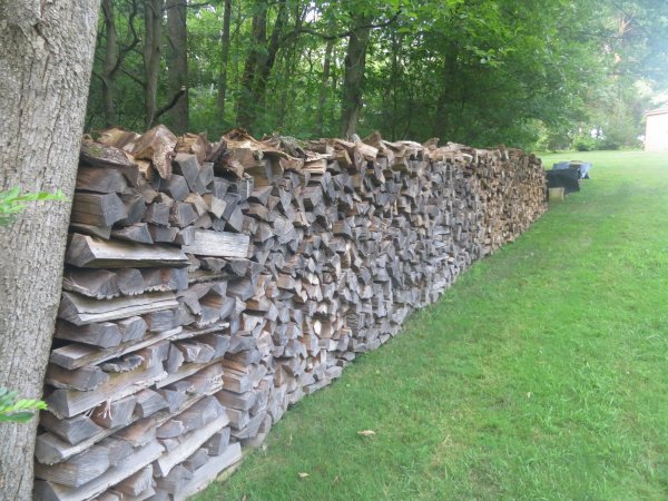

    The Alder here goes through quite a bit of color changing during the seasoning process. I haven’t paid any attention if the sun or shade makes a difference. We sure get more sunlight on the wood pile after they logged the property behind us.
    Just took a quick look and the stuff on top has bleached out more than the wood in the shady part of the pile. [​IMG][​IMG]

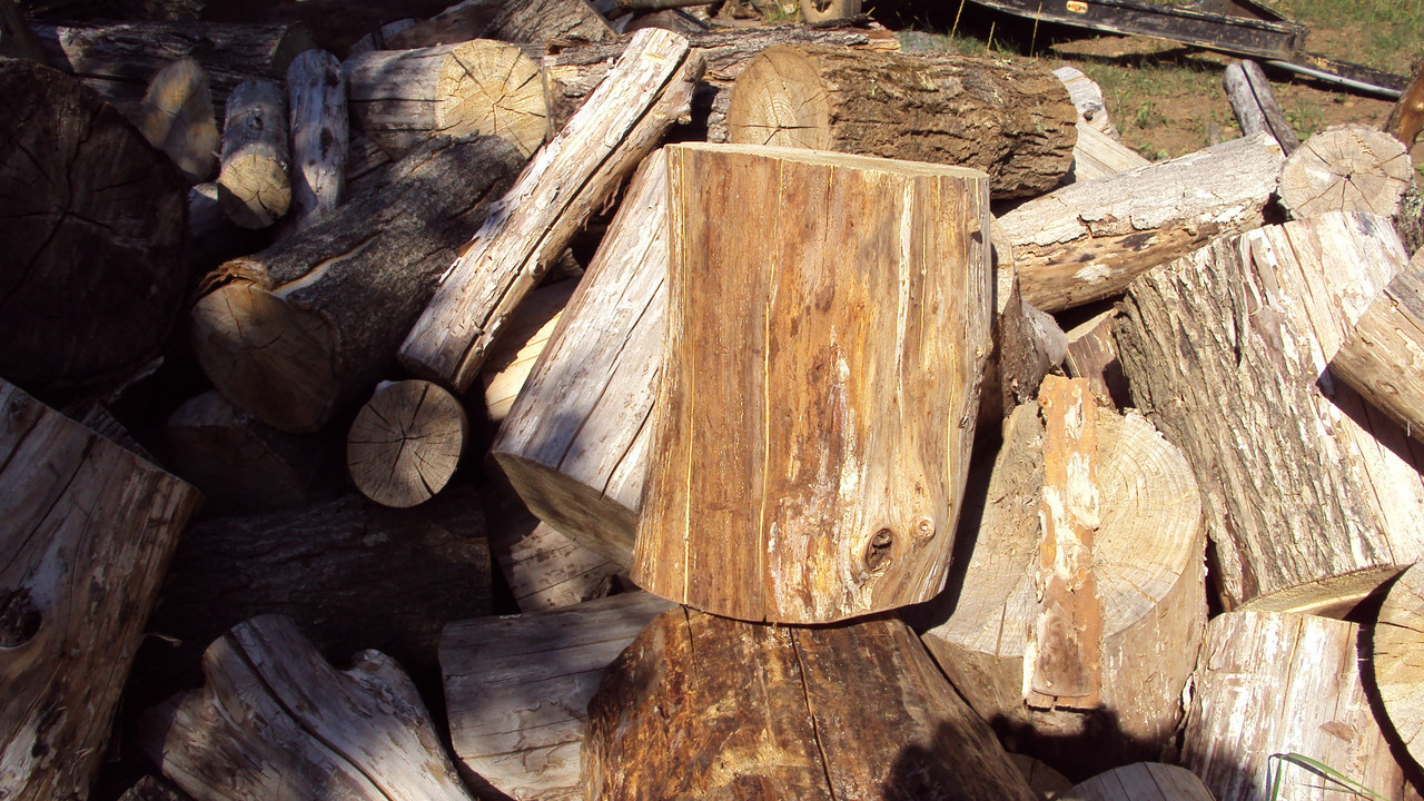

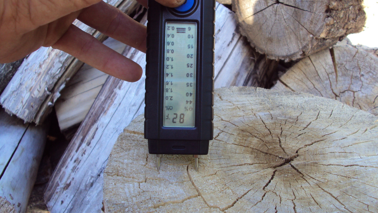

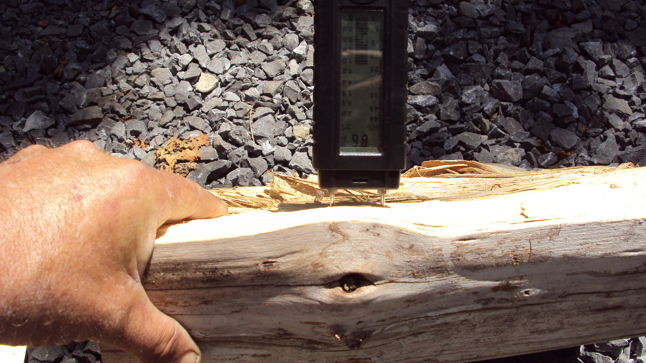

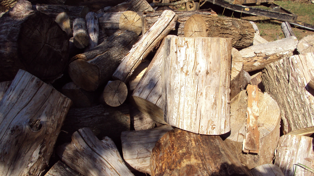

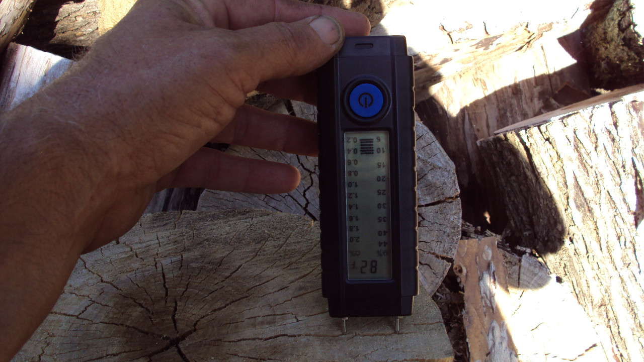

    Went out and checked the top of the pile today Gr and found this. :coldone:
    Around 6 weeks.

    I think the more gray side shows a lot. The sun turns the wood gray and the more sun, the more drying going on. I have found even a few hours per day less sun makes a huge difference throughout a period of even just 6 months. Many of you in here have seen my “piles” and I can tell you orientation even makes a difference. I have found that running my windrows north-south dries better than running them east-west.

    The unsplit pieces are not firewood. It doesn't start to truly season till it's split.
    Also when using a moisture meter it must be taken internally on a fresh split not on the end.

    Its still out by the splitter and will split and meter it in a bit Bandit.:salute: :cheers:

    curious to see the readings on the pictured logs once split

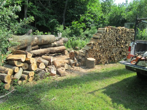

    Unfortunately all my stacks are in shaded areas. One stack of red oak gets some sun. The sun and wind do make a world of difference in drying wood. I have a stack/mound at an area im currently cutting and am amazed how well its dries in the full sun. IMG_0556.JPG
    The logs are maybe two years old uncut.

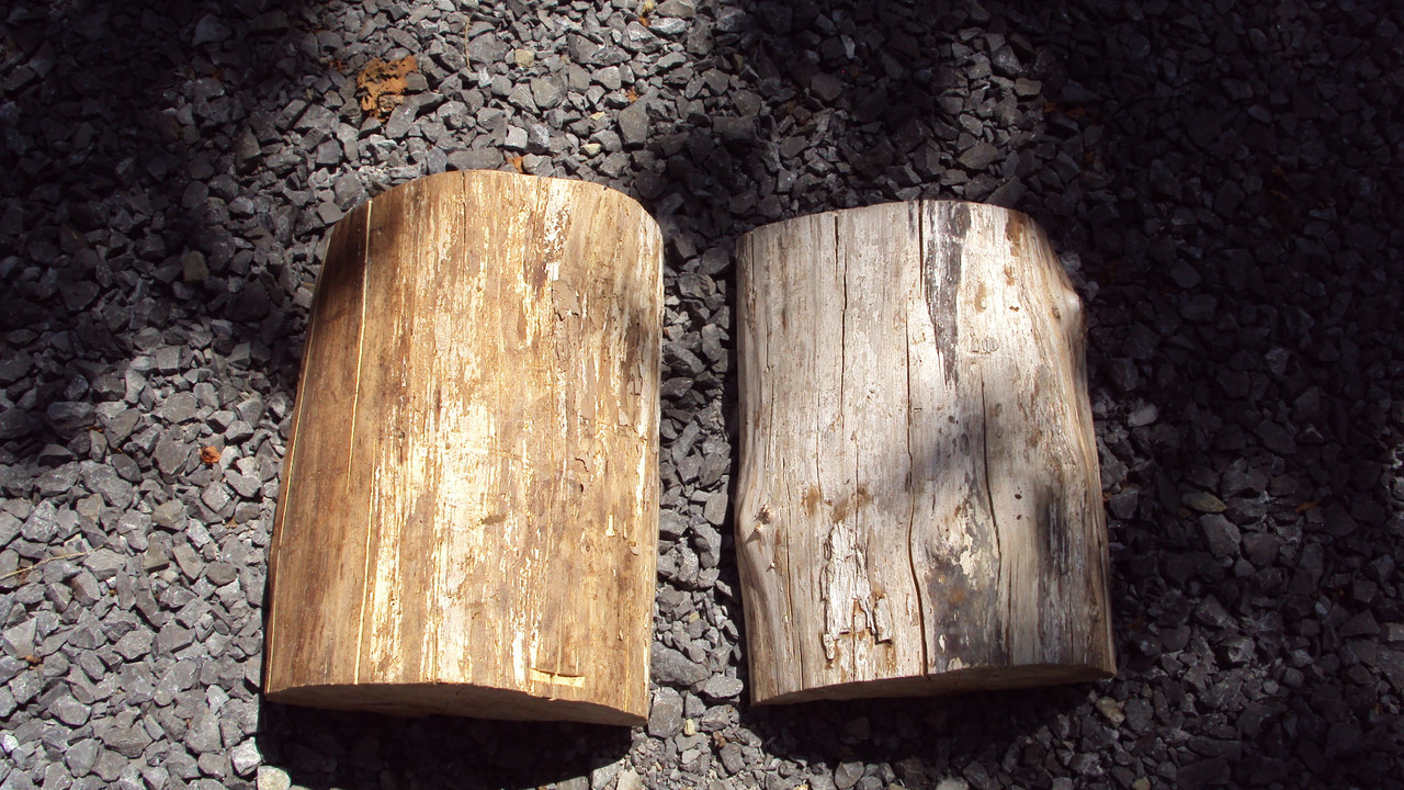

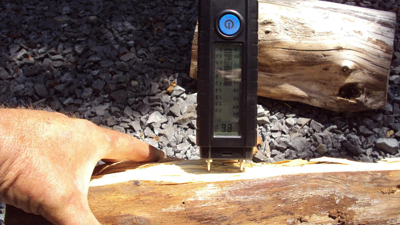

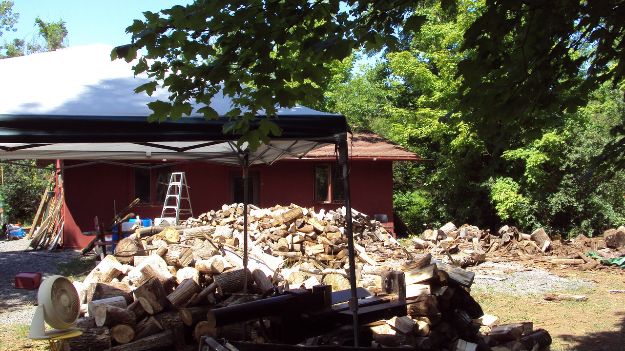

    Ended up getting the fan and tent set up and did some splitting today and got a whack done.:yes:
    Here's that sun burnt block.
    :coldone:

    good looking work Loon ! What species is the sun burnt block?

    Thanks buzz and it was an easy splitting elm with some maple and ash in todays pile.:coldone:
