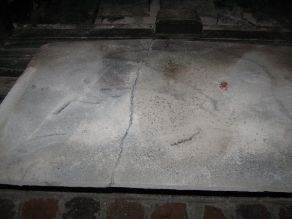

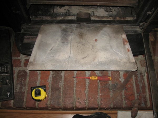

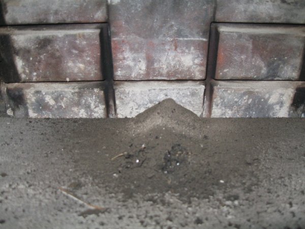

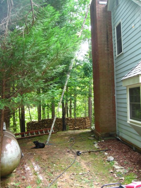

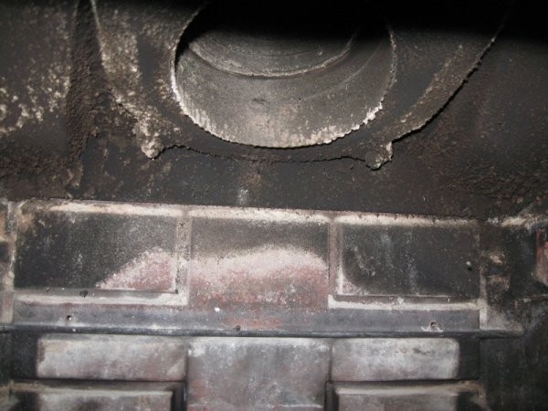

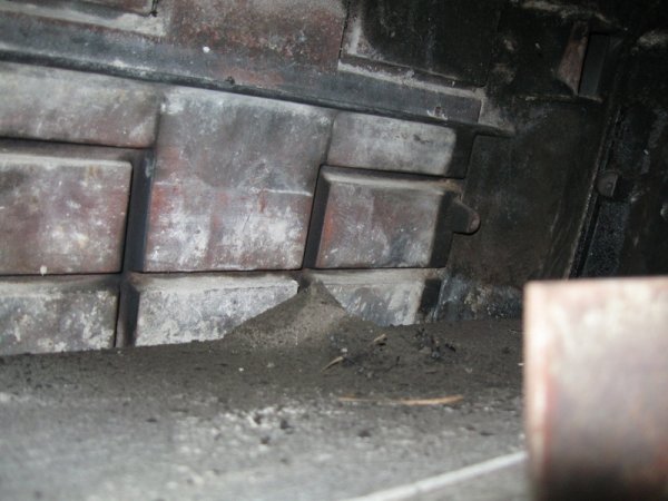

    Decided to get everything ready to go today. Picked up a new gasket yesterday, it got beat up pretty bad from coals spilling out on some of those cold days last winter. Going back together with everything and I decided to finally widen the right rear baffle screw slot. It's been tight since new and finally bent the screw last season (luckily came out without issue) - of course as I'm dropping the baffle a second time my thumb slipped and the baffle broken in two:mad:.
    Then again its times like these I'm glad I take all these screws out and anti-seize them every year, and never tighten ANYTHING snug only. Those little Phillips pan heads that hold the baffle clips were a PITA to get loosened the first time.
    First few pics: soapstone removed, a couple of pics of the flue with the baffle removed, ladder setup - ready for the climb

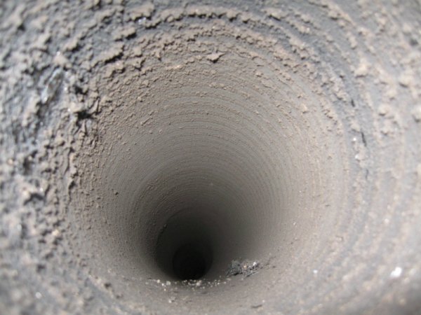

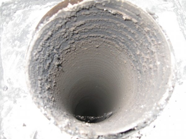

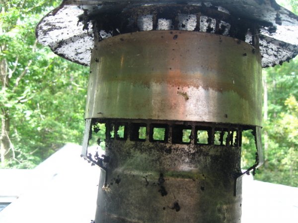

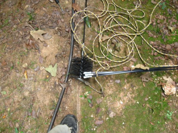

    Next few pictures: Brush tied up, I throw a wire brush and screwdriver for the cap in my cargo shorts.
    Cap prior to cleaning - black snot and cobwebs, most of it bangs off easy

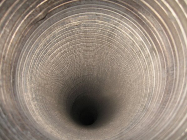

    Two shots down the liner - typical of all my clean outs, 10-12" of creosote right near the cap the rest light brown powder

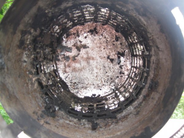

    Cap removed and cleaned
    A shot down the liner after brushing
    Two different pics of what came out of the liner
