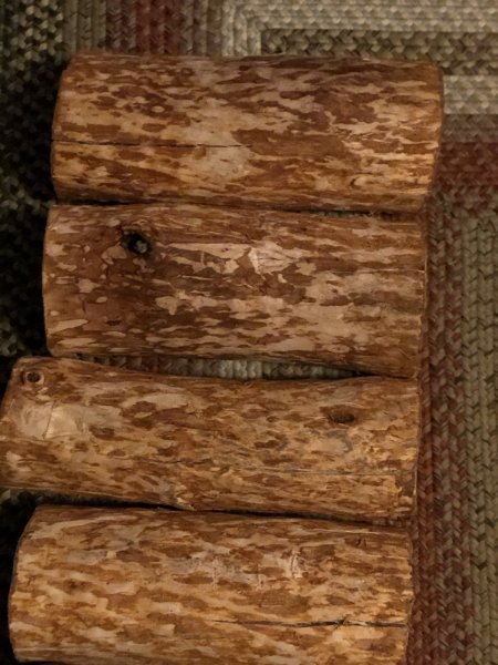

    I cut some Cherry about 2 weeks ago & thought I would make some Swedish Candles from the pieces for next year but...
    The rounds are 6” - 8” dia. 2 are round, 2 are oblong.
    15-1/2” - 17” long. I drilled a 3/4” dia. hole, 2” shy of going all the way thru the length,
    Then I debarked them, I had a draw shave on order but it was “moving within the USPS system” so I used a flat spade to debark. Naturally my draw shave showed up today
    6CCE167F-ECBF-4F00-AC98-F9163F783A3E.jpeg DB449CF6-B40D-48B9-A909-A602387316F8.jpeg

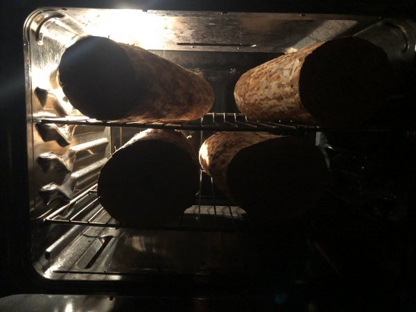

    Then I put the 4 pieces in the “kiln” for 16 hrs @ 180*. Some might call it an oven but it’s just semantics. :whistle::picard:

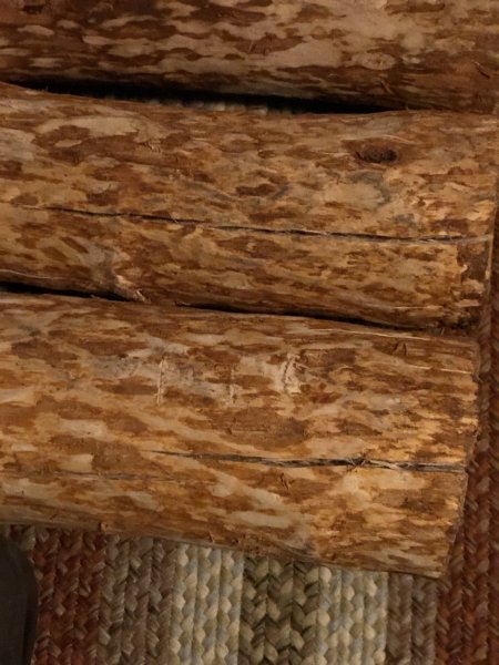

    I may have dried them a bit too long see the pic with the large cracks in 2 of the pieces.

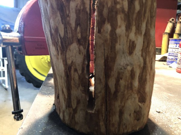

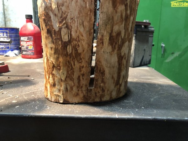

    I gave 2 of the 4 to a friend, gave the pictured one to my mother & kept one to burn. The pictured one I cut too low, usually try to stay 2” from the bottom on my slice cuts. It was starting to rain & I was rushing a bit to get the last one cut. The ends show some pretty good checking from drying. When I put the X-cuts in there was a bit of what appeared to be steam coming off of them.
    D4819102-E96D-4476-94A0-57EEE9D47025.jpeg C5C2883E-244C-4516-A59A-103FA3511E6C.jpeg 29109397-D844-4989-854F-B7EAD8FC5631.jpeg
    After drilling 5 of them out, I have a nice bowl of fragrant chips/shavings. I gave those to mother also.
    Also pictured is the weapon of choice for drilling the center hole. I knew Dad had an extended bit but didn’t realize it was 28” long but it works & beggars can’t be choosers.

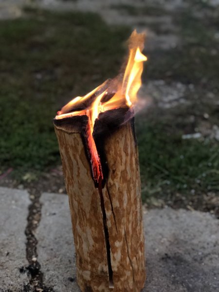

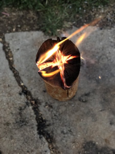

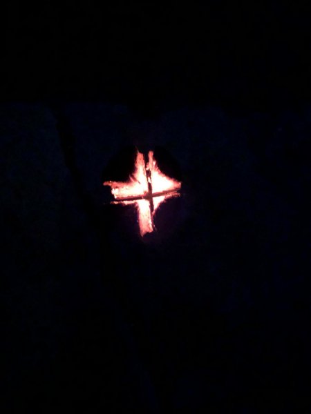

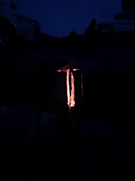

    Welp, I believe my initial experiment is a bust. Initial lighting looked good,
    B830420F-3A6E-43BE-ACE2-131B6024D77E.jpeg FD6EC953-86A1-4DFB-BD81-AEDE0888BFEF.jpeg
    30 min. in looked good,
    E017D11F-DF88-4E17-A171-6E4270A881BE.jpeg C0FE3E94-75BD-46D7-B6FA-694C136E2204.jpeg
    1 hour not much in the way of flames.
    FE61C93C-DE5B-41F0-B497-668A33A17F08.jpeg 684BC1F2-2F72-40ED-9BA3-45D37845BEAB.jpeg
    There was about a 5mph breeze when I lit it, then the breeze gradually petered out. I am thinking that the wood was not dry enough, there was no sizzle but just not sure of the moisture content. I suppose the only way to get an accurate measurement would be bake one, let it cool sufficiently, split in quarters & check it with a moisture meter. I fanned my hat on the candle & it flamed right back up. I need to do more research. There was a pleasant aroma when it was burning good.
