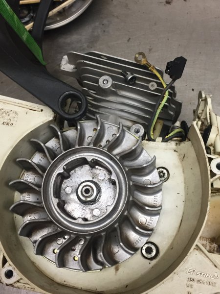

    This happened.
    Any best words of advice on getting this out?

    Depends on what kind of tools you have. It's kind of low to weld a nut on there. IMHO, those extractors are worthless unless the item you're trying to extract is already loose which this doesn't appear to be. You could throw it on a bench, then drill and tap it. Trying to drill out the non threaded portion might be tough to get aligned with the drill bit but certainly worth a shot. If that doesn't work, you can drill the hole a bit larger and then just tap it with a plan to use a bit larger hardware.. If you do want to try an extractor, you could heat it up with a torch first to loosen it up.. Just a few thoughts to get you started..

    Drill a smaller hole in the middle. Tap a torx drive in it and back it out. Worked for me a couple of times. There was that one time that I snapped off the extraction tool in the snapped off bolt. That was a bad day.

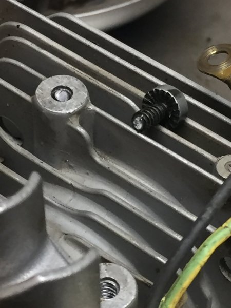

    I would definitely try to extract it before drilling it out and would put some good heat to it.

    Center punch first so drill stays in center. Drill it . Heat aluminum. Use an easy out should come right out. Remember aluminum will stay hot for awhile. We do this weekly on all these new vehicles and school buses.

    Worse comes to worse do a helicoil. He's got plenty of meat around that broken bolt to put 1 right in.

    As with any situation there is always more than one way to skin a cat. I’m glad heating works for you. In my experience heat and drill/ easy out would be my last chance Hail Mary. 17 year Ford senior master tech here, I have removed a few broken 5.4 + 6.8 manifold studs. Mig welder and a nut works 99% of the time.

    Have someone tig a few dabs of rod, preferably stainless so the vice grips can grab it. This works well on broken taps also.
    To save time using easy outs...carefully drill the hole and insert the easy out firmly in place. Then take a hammer and break it off flush with the end of what you want to remove. This saves you all the time you'd waste trying to back it out while squeezing your butt cheeks.
