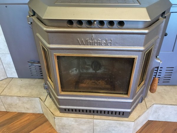

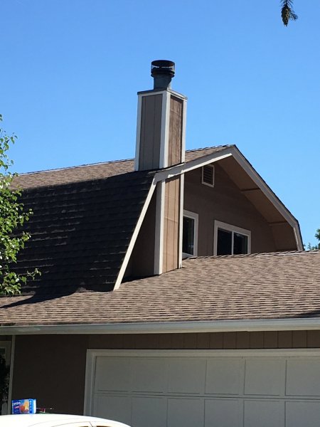

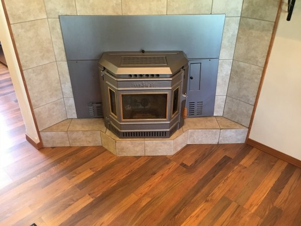

    So we got back from the house after we had a vicious chat session as if we were right at home, :rolleyes: dunno what that means but the lady in charge loves it, I’m down with it so we made the offer. Now for your salivation purposes ....the stove and chimney. E57000A1-A803-4863-B43C-2F2C1592888A.jpeg Looks ok from here. The stack itself is wide so I’m on a hunch thinking that chase could be hiding some 6 inch pipe. Definitely no stone in there. House was built in ‘78 but likely remodeled somewhat for additions. 0945B3CD-79AC-4197-A212-F43F7453319E.jpeg

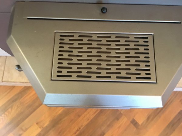

    The stove is a Whitfield, I’m not familiar at all so maybe someone on here has one? Looks relatively new...maybe within 5 years? upon closer inspection I also noticed the side panel door had a screw out and it moved a little bit. What I could see without going further was likely the working mechanism for the stove, perhaps for servicing? Just had to tinker a little bit to see some stuff but nothing serious. Inside looked pretty good too but I don’t know how I feel about the gasket until I know more about the installation from the sellers.
