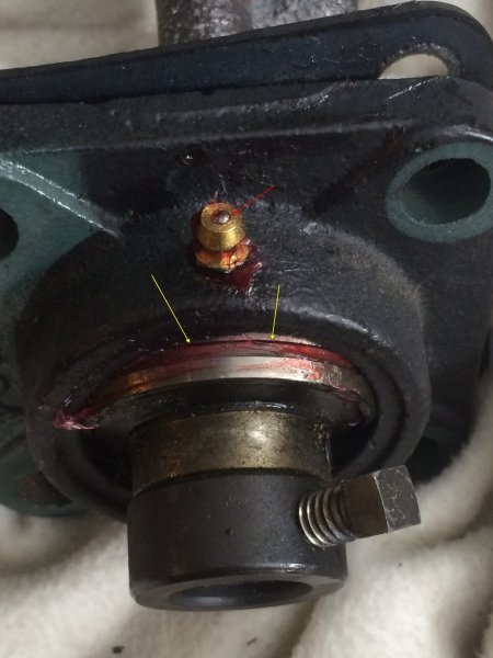

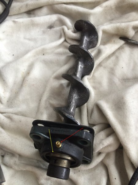

    These auger bearings were dry! See dry channel in pics below. Pellet stove is 2009 and auger and bearings were never removed until now!

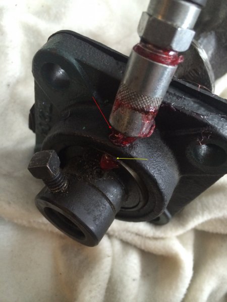

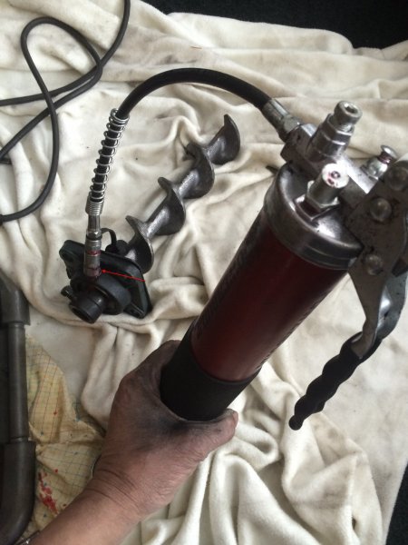

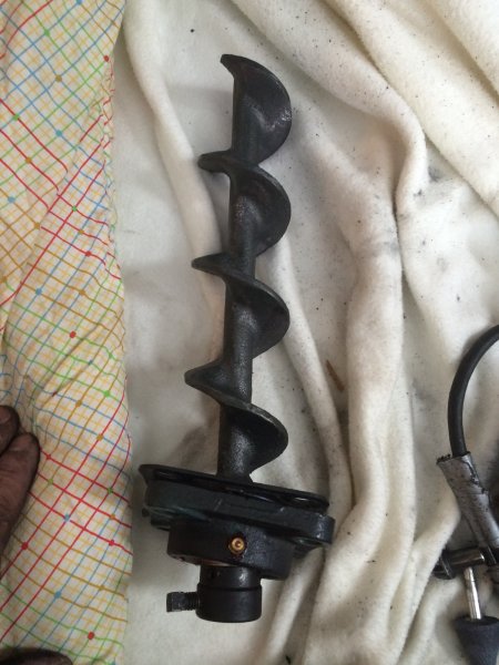

    Here we pump Red High temp grease from a cartridge into the alemite fitting using a grease gun purchased from Lowes or Home Depot.
    How often do you apply the red stuff.
    Pic 1 - Bottom Auger with BONE dry bearing! See empty grease channel.
    Pic 2 - Grease gun setup

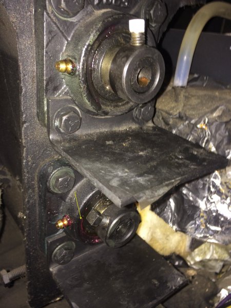

    Pic 3 - Squeezing in the red grease
    Pic 4 - filling the channel
    Pic 5 - Greased auger - sprayed with "Dry Moly" after wire wheel brushing and grinding rough spots

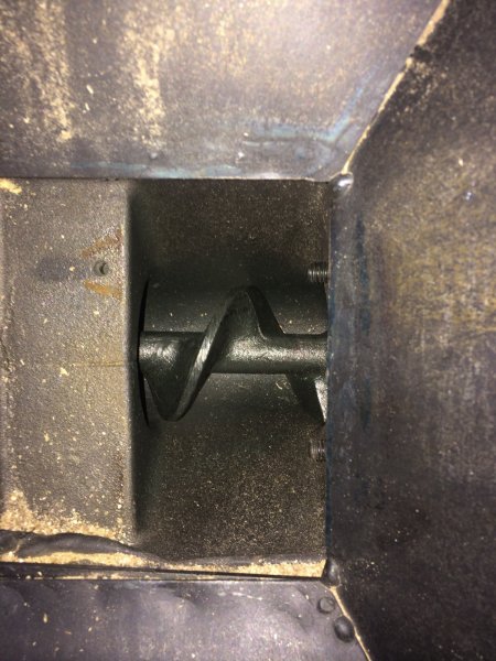

    Pic 6 - Align Augers and check to see if they turn freely. Zerk fitting on left for easy access

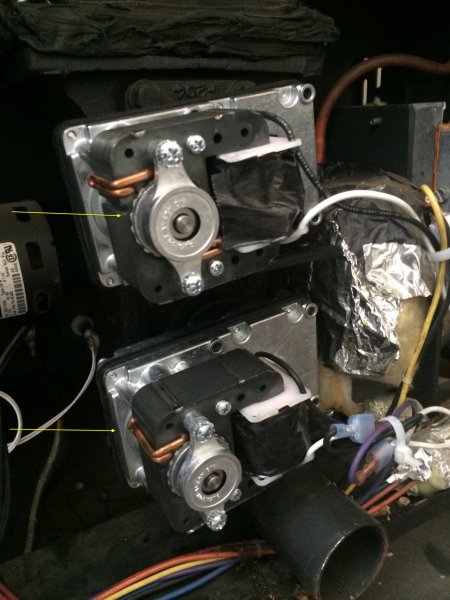

    Pic 7 - New Hi Quality auger motors
    Pic 8 - Top auger in hopper
    Click pics to Enlarge:
    See Yellow and red arrows!

    Been away.Good normal maintenice stuff don.Please tell me how you "aligned" augers in picture 6?
    wildwest likes this.
  4. don2222
    don2222
    Nov 10, 2013
    3,341
    4,625
    Salem NH
    Hi
    In pic 6 when you put the bolts into the large bearing holes there is quite a bit of room to move the bearing up or down or to the left and right. Natural gravity pulls the bearing down. Therefore if you tighten the bolts and the auger hangs when turning it by hand you may want to move it up and/or slightly to one side so the auger turns freely. I have done many of these and each stove is different.
