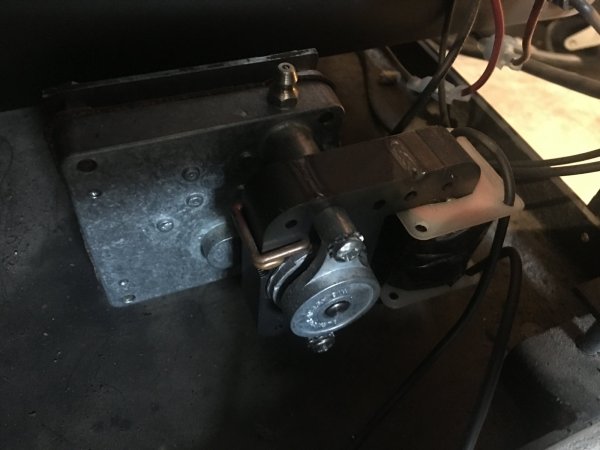

    The St. Croix versa motor is approx 1.3 RPMs and is a counter clockwise motor just like the double auger CCW England Stove Works 1.2 RPM auger motors. The o.1 RPM difference is negligible. However the bolt pattern is different so the standard auger gear motor will not bolt right in. There is however enough room on the bracket to just drill another set of approx 1/4” holes and Bingo, you can slap in a nice standard 1 RPM gear box motor! In this example I used a High Quality Gleason Avery Auger Motor with Needle Bearingd for that extremely long life! Also I got another versa bracket to start fresh and it comes with a new bronze Bushing.

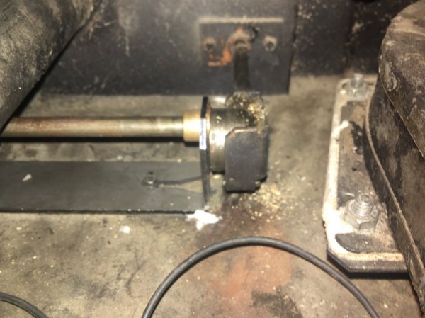

    1. Remove versa motor with box wrench and Allen key

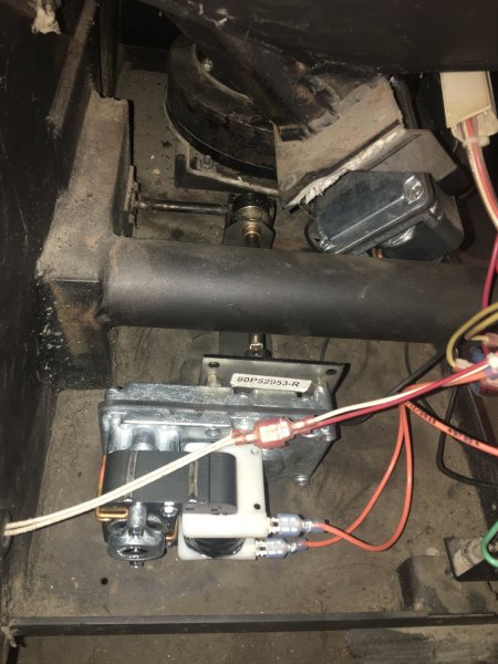

    4. Mark and drill new holes in versa bracket making sure the new auger motor shaft is in middle of bracket hole.

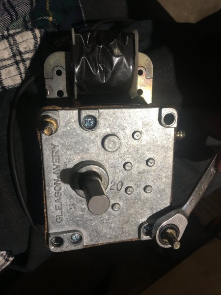

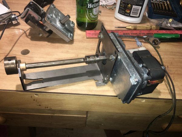

    5. Remove studs from old versa motor and screw into new auger motor.
    6. Bolt new auger motor into new holes in versa Bracket

    9. Make wires to plug on new auger motor and stove with spade clips. See orange wires in pic below.

    Pic 1 - old versa motor
    Pic 2 - Removing studs from old versa motor
    Pic 3 - installing studs on new auger motor
    Pic 4 - Installing versa bracket with new set of 4 holes.
    Pic 5 - Bench testing motor with bracket & Bushing
