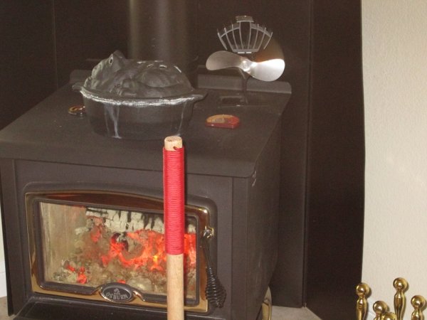

    I use parachord. I drill a small hole at one end to put the chord in and smear epoxy on the area I am going to wrap and then put a small hole at the other end cut the chord to length and tuck the end in.
    I have never had it come apart on any of the mauls, axes, or hatchet's that I have done.
